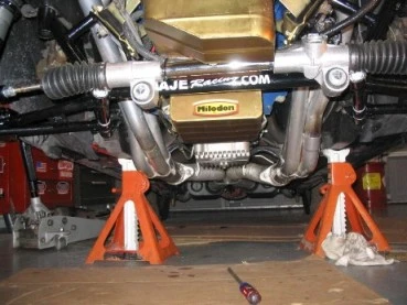

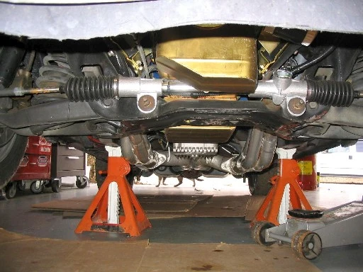

This is how much extra room you have under the engine with a tubular K member compared to a stock k member. With the K member gone you have complete access to the oil pan. It is more difficult to install a pan gasket upside down but is done everyday.
