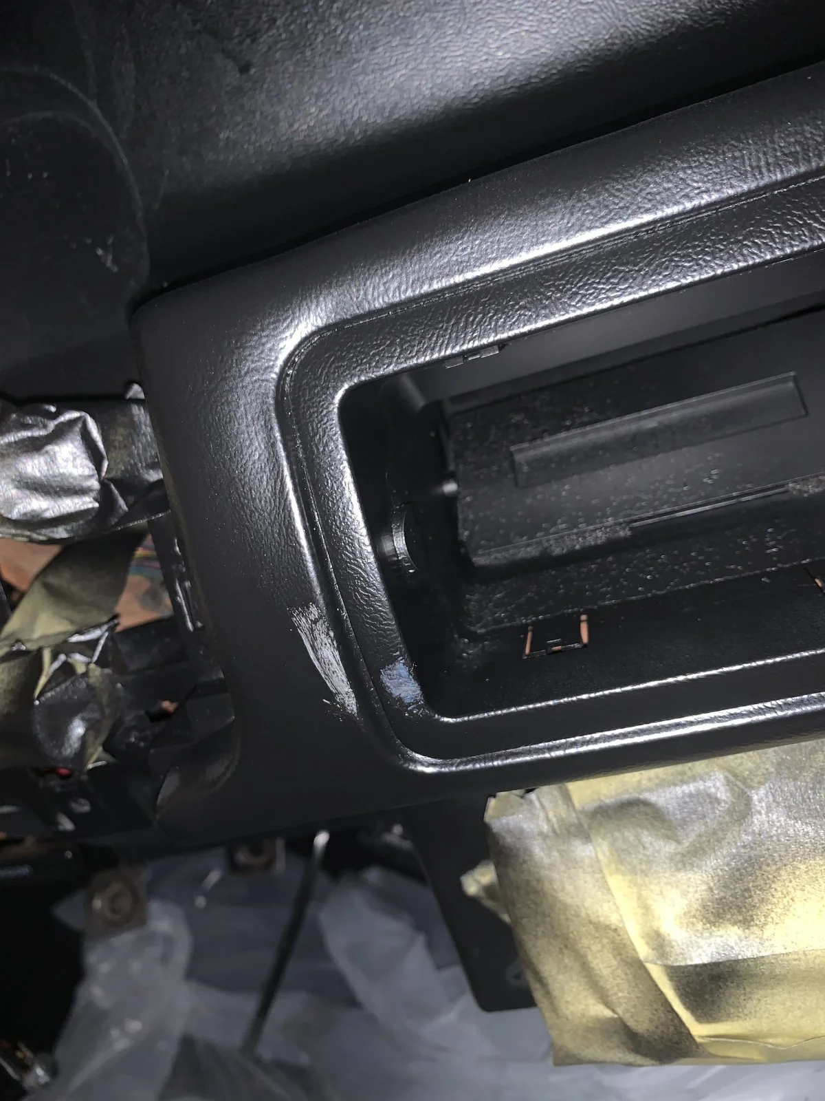

Will not really an issue. But as i was painting my interior, a big bug got on the paint & my dumb self tried to take it off & messed up the paint a little. Is there a way i can fix this without starting over? Or just spray over it?

Don’t touch it anymore. Tape off the small spots and paint only where needed. If you paint a over it widely, you will have overspray that is dead obvious. Try to make the mistake as minimal as you can be only painting those small spots. Sucks, but is what it is, unless you want to start over.

I’d let it dry and then use a number of very light coats to fill it in.
