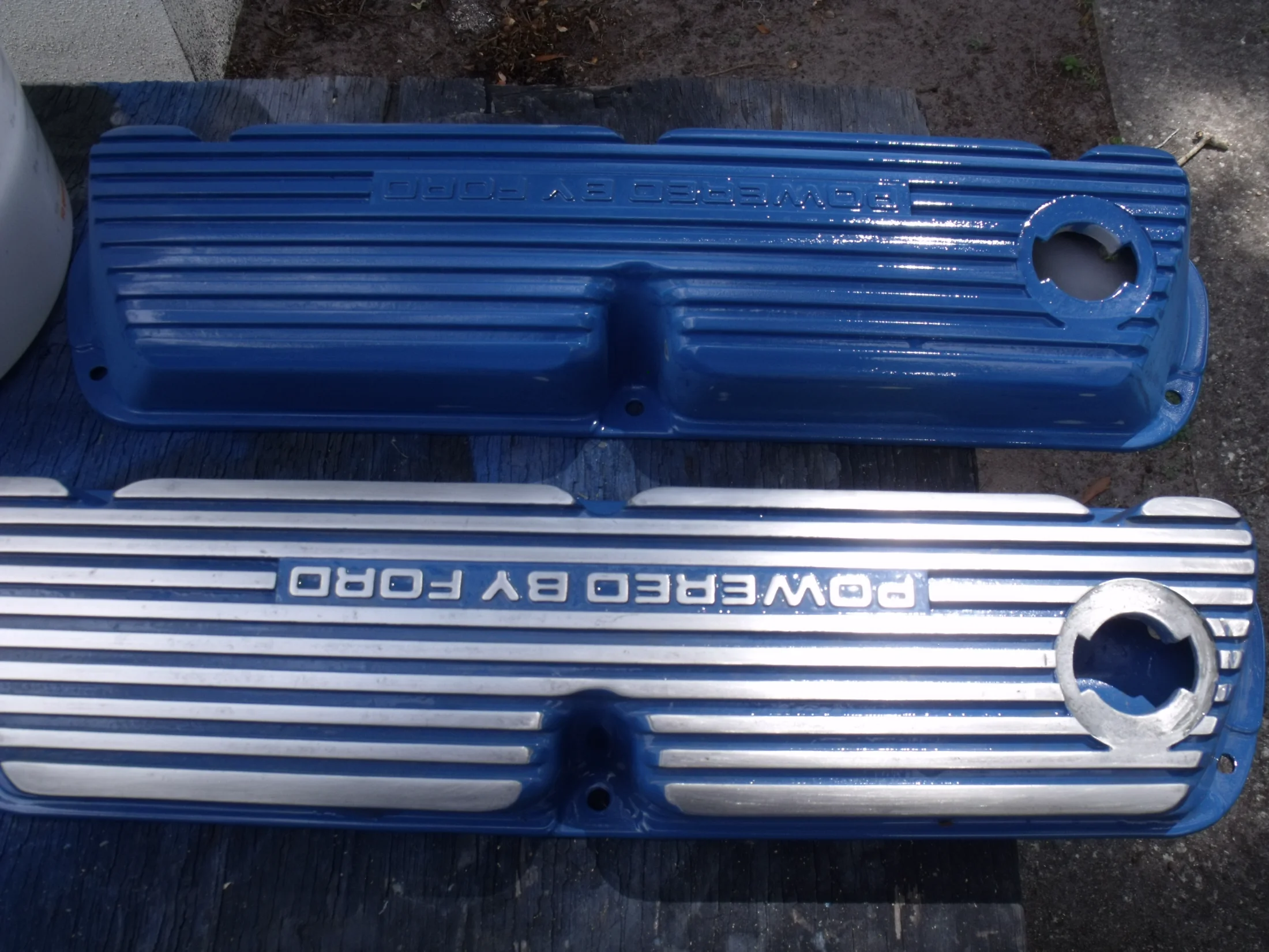

Before and after Valve covers... Same idea
Cleaned them up with sand paper and wire wheel, paint the entire surface, then sand off the paint on the ribs and lettering
