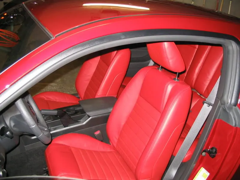

I spent a little time inside of my Mustang, but not driving it. I wanted the red and black interior from the start, but couldn't find one within a thousand miles.
What do you think or
Before
http://i75.photobucket.com/albums/i292/zetecwagon/109_0949.jpg?t=1204042044
http://i75.photobucket.com/albums/i292/zetecwagon/109_0950.jpg?t=1204042136
During
http://i75.photobucket.com/albums/i292/zetecwagon/109_0954.jpg?t=1204042214
http://i75.photobucket.com/albums/i292/zetecwagon/109_0955.jpg?t=1204041737
Almost done
http://i75.photobucket.com/albums/i292/zetecwagon/109_0957.jpg?t=1204041824
http://i75.photobucket.com/albums/i292/zetecwagon/109_0958.jpg?t=1204041872
http://i75.photobucket.com/albums/i292/zetecwagon/109_0960.jpg?t=1204041949
Still have some work to do on the doors.
Charcoal seat covers will be up for sale or trade.

Looks good. How hard was it to swap the leather? I have some red leather I bought off someone on another board, but haven't decided whether to do it on my own or take it to a shop.
bigcat
start with the upper hole, and if more traction is
May 1, 2005
3,015
79
7200 feet
Feb 26, 2008
  • Feb 26, 2008
its a bit of a PITA. you have to be sure to put the hog rings in the proper spots, or the covers will be loose and look like crap.
it is doable yourself, just takes a little research before you tackle it.
G
GT Dave
Jul 7, 2007
34
Cincinnati, Ohio
Feb 26, 2008
  • Feb 26, 2008
Def a PITA, but a new learning experince. Takes a lot more time than you may think. Unless you do that kind of work day in and out.

i am getting ready to install leather in my car, bought it with cloth and got a leather take-off for $300. saved alot of money since all the cars with leather had tons of extras i didn't want to pay for. Any tips for the install or things to stay away from
G
GT Dave
Jul 7, 2007
34
Cincinnati, Ohio
Feb 26, 2008
  • Feb 26, 2008
Yes! see if you can find replacement clips for the plastic trim on the seat bottoms so you can just tear out the old. You need 2 for each side. Saving the clips was a huge PITA. Use a little soap to make things slide easier, like headrest and seat backs. If you have power seats remember to raise them all the way before removing them. You may want to have some gloves and or band-aids handy, the stainless on the frames has some very sharp edges.

To me, the red leather looks ok, but I don't think I could live with it day in and day out. Also, I don't know if I've ever paid attention to a non IUP GT...ugly steering wheel and no upper dash trim panels! Yours doesn't look too bad being that you extended the silver lower on the dash and around the center console and head light switch. I can see you have put quite an effort into it and the job looks nicely done. I have to give you credit on that
