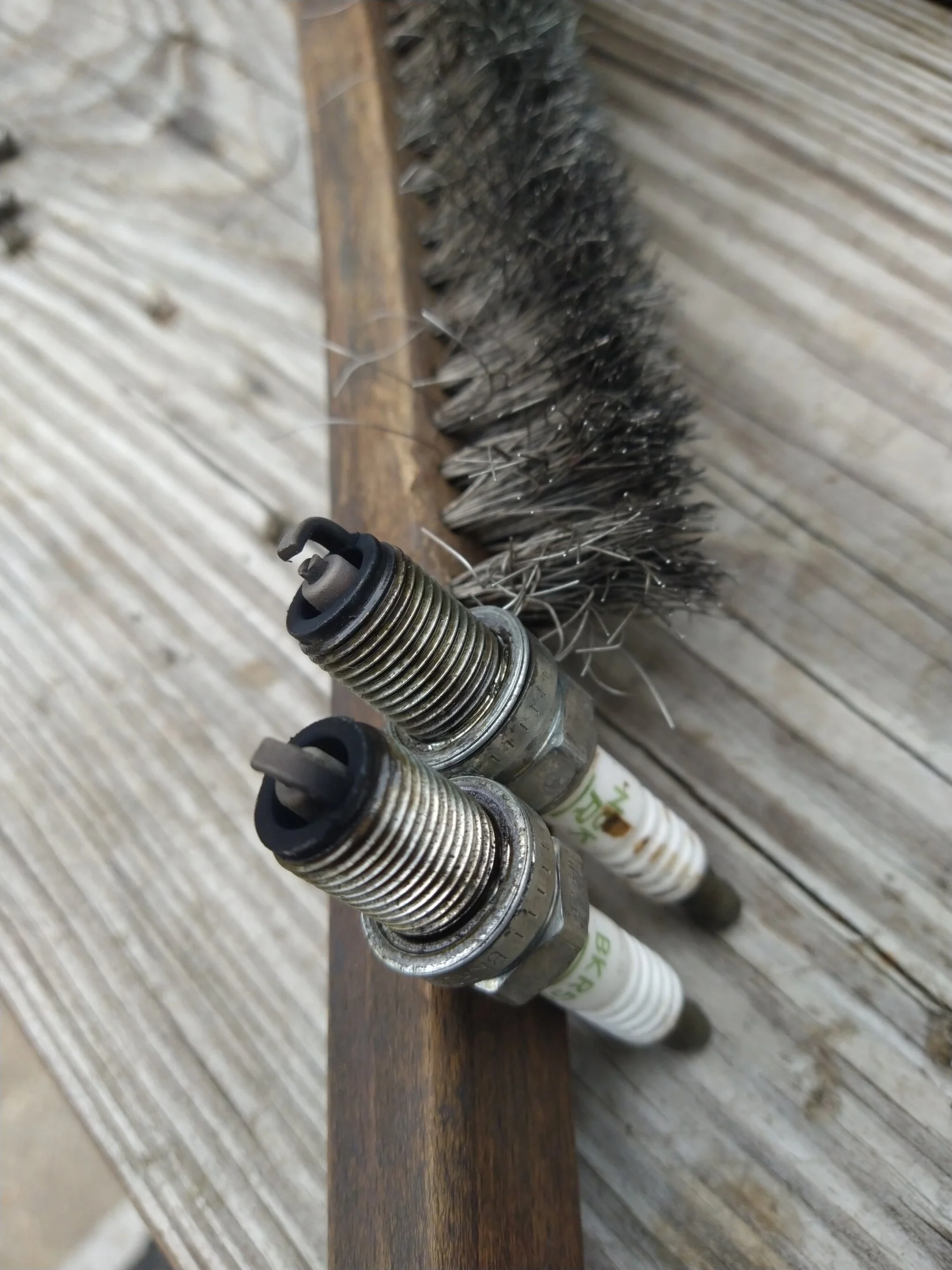

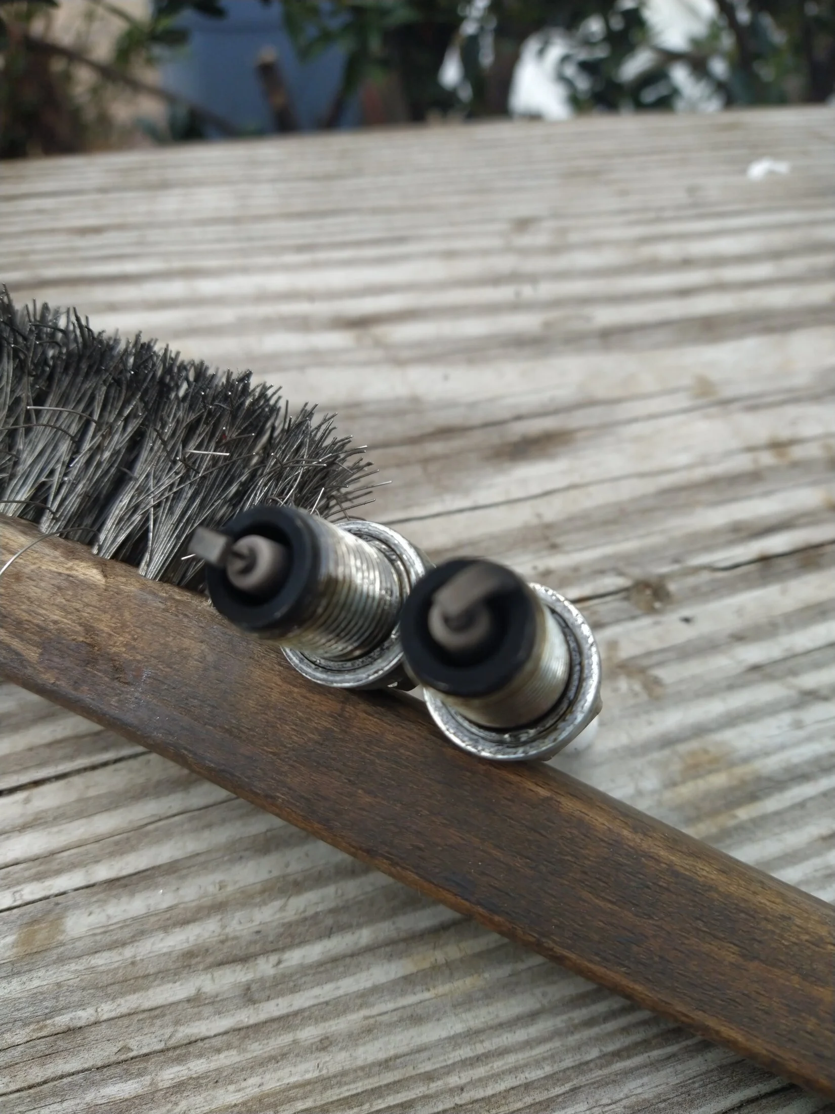

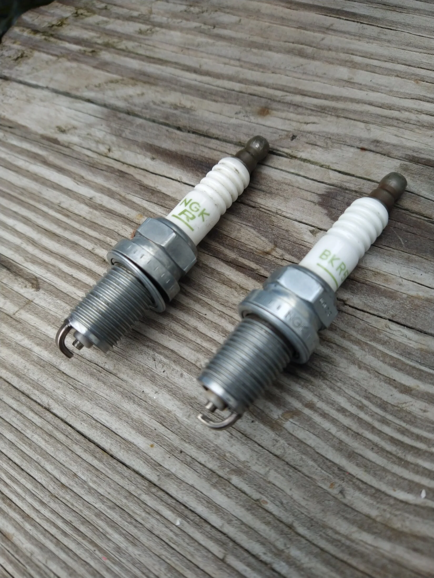

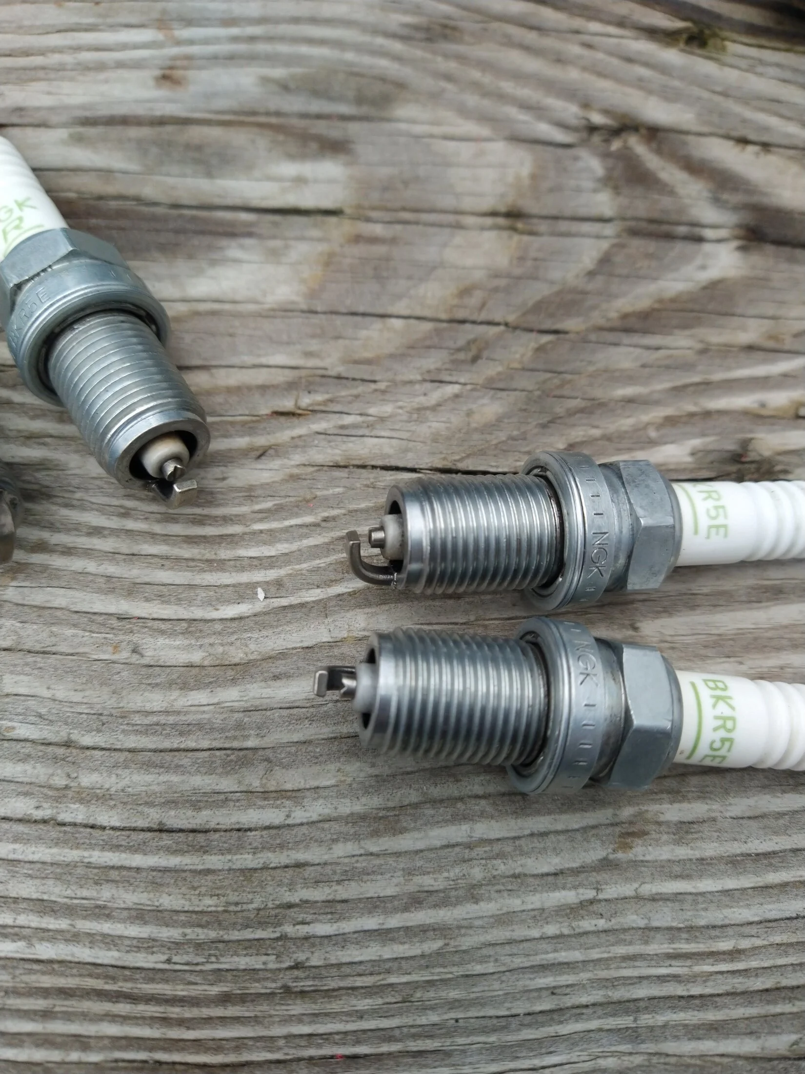

Heres what I do every time I change the oil and only takes maybe 20-30 minutes to do...
Before I drop the oil I pull my 02 sensors and I put them in a glass of lemon juice to fully clean them while I do the oilchange then when done with the oilchange I rinse the 02 sensors in a vinegar bath then rinse off the vinegar with rubbing alcohol and reinstall after blowing them dry with a heatgun...
The lemon juice works quickly at attacking also loosening up and removing the carbon build-up and the vinegar makes the electrode tips on sparkplugs really clean as the lemon juice and separate vinegar bath / alchohol rinse trick works great on sparkplugs too and sometimes needs a lil light help from a wire brush but never use a wirebrush on an 02 sensor...LOL

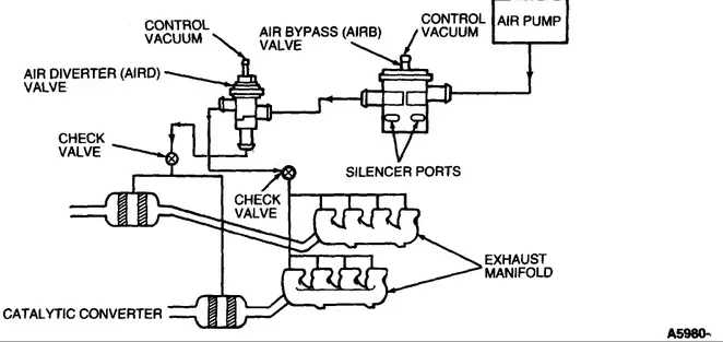

<edit>(try to append diagram on Secondary Air Control vacuum diagram)
<bump> The fault code came back.... and I've left the vehicle back with the master mechanic to figure out what the issue is. It has new valves (discussed above), new O2 sensors... the supplementary air pump was replaced 2 years ago... all the pipes look intact... so now my guess is MAYBE there's a problem with the relay that turns the supplementary air pump on, or with the wiring.
Or maybe it's one of the check valves (see the above diagram). Guessing, now.
<edit> I just noticed that the above diagram doesn't show the locations of the O2 sensors.
If I remember correctly, there should be one both before and after the cat converters (total of 4 in the system).

The code came back, and it was back in the shop. So far just about every component had been replaced in the whole secondary air system, with the exception of the check valve. So that is what I presume that the mechanic replaced on this final trip to the shop. When I picked it up, the repair order had no part number. He said that had to find one in the secondary market, so if anyone has further information on the check valve (part number, pictures, etc) it would be much appreciated.
I'm guessing that it's this one: Part Number: XR3Z-9F491-EA
