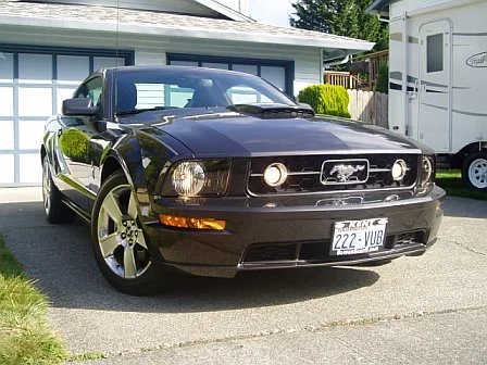

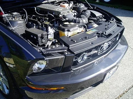

I didn't say that my friend "needed" the GT bumper cover to make the GT grille/lights fit, I merely said that he had one available, so it made the swap easier. He bought the entire GT body kit (front and rear bumper covers, and side rocker panels) from someone who did an aftermarket body kit on their GT. Both cars were black, so it was a direct swap with no painting needed. He did not get the GT grille/foglamps in the deal, so I offered to trade grilles with him straight across.
Putting the V6 grille/lights into my GT's bumper did require fabrication. We tried to force the side mounting tabs to line up, but they kept popping out, and the top/bottom tabs don't line up at all, so I made my own brackets.
Both cars were done using Ford factory parts. Sounds like some of you are referring to aftermarket grilles that are avaiable to make the swap more easily (albeit at a higher cost).
Lastly, as my friends V6 already had the Pony Package with the foglights, we did absolutely zero wiring. The wiring for the Pony lights and my GT lights were absolutely identical, and the factory fog light switches worked perfectly in both cars after the swap.
