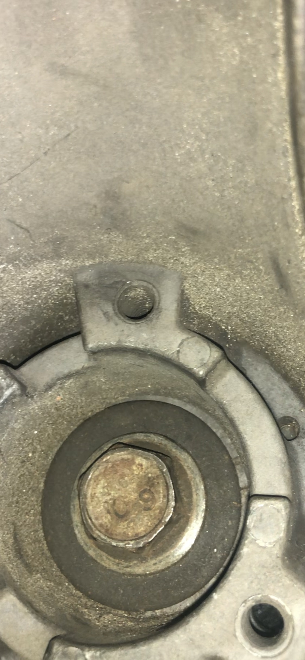

went to pull off the i don't think my year has rotor style system, besides that I went to go turn the crank bolt and 15/16 6-point would not stay in there snug The bolt looks like this, not sure if it's rounded of,f but the socket would catch on some parts of the bolt but not all

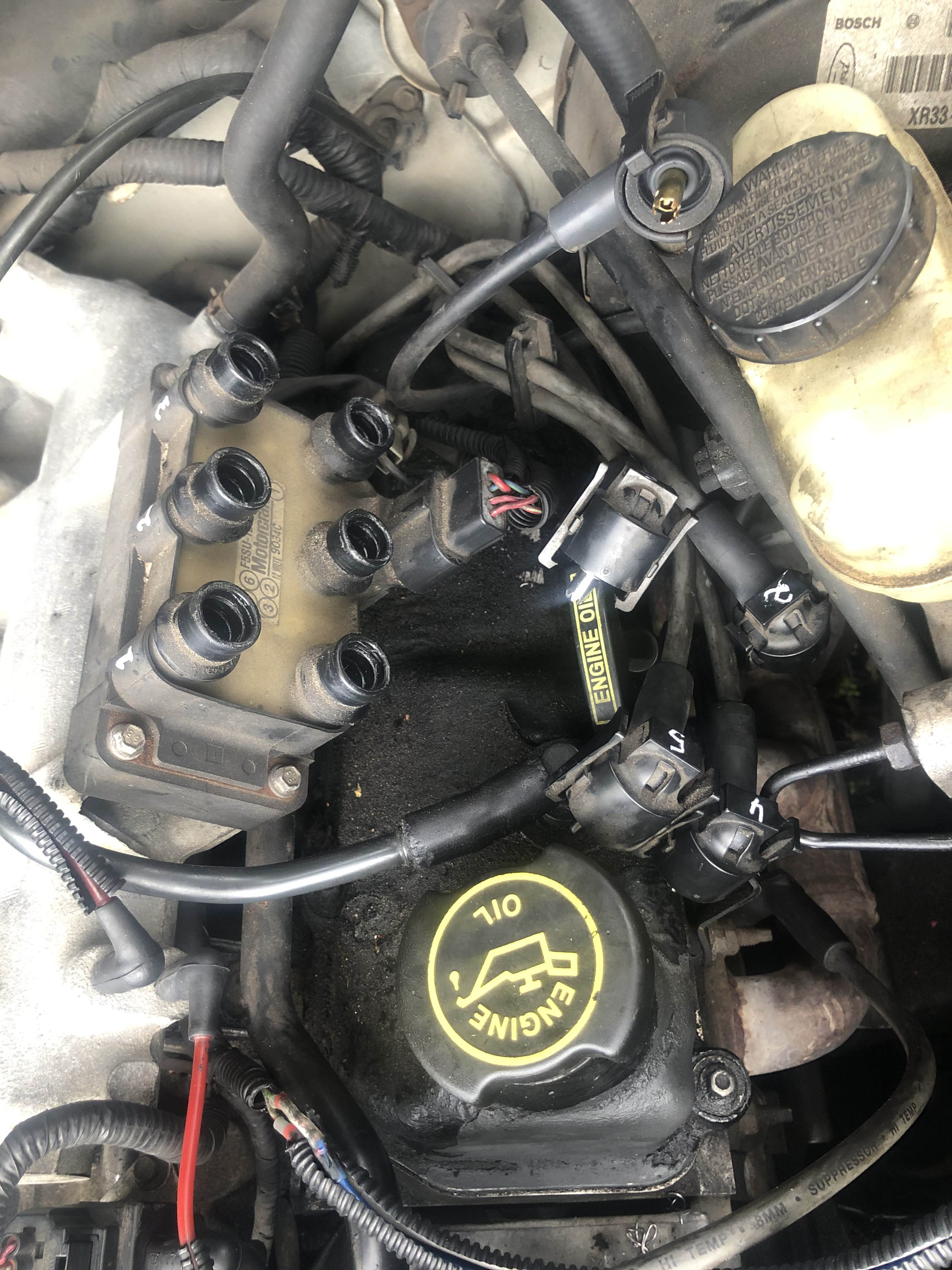

Pretty sure you have a distributor-less ignition system , should have coil pack(s).
Will it crank with the key?
I have these if this is what you're referring to, and yes, it cranks when I turn the key, but now I hear a single click of the starter and no crank, not sure if I burnt out my starter or not (the wires were not out when I tried cranking)

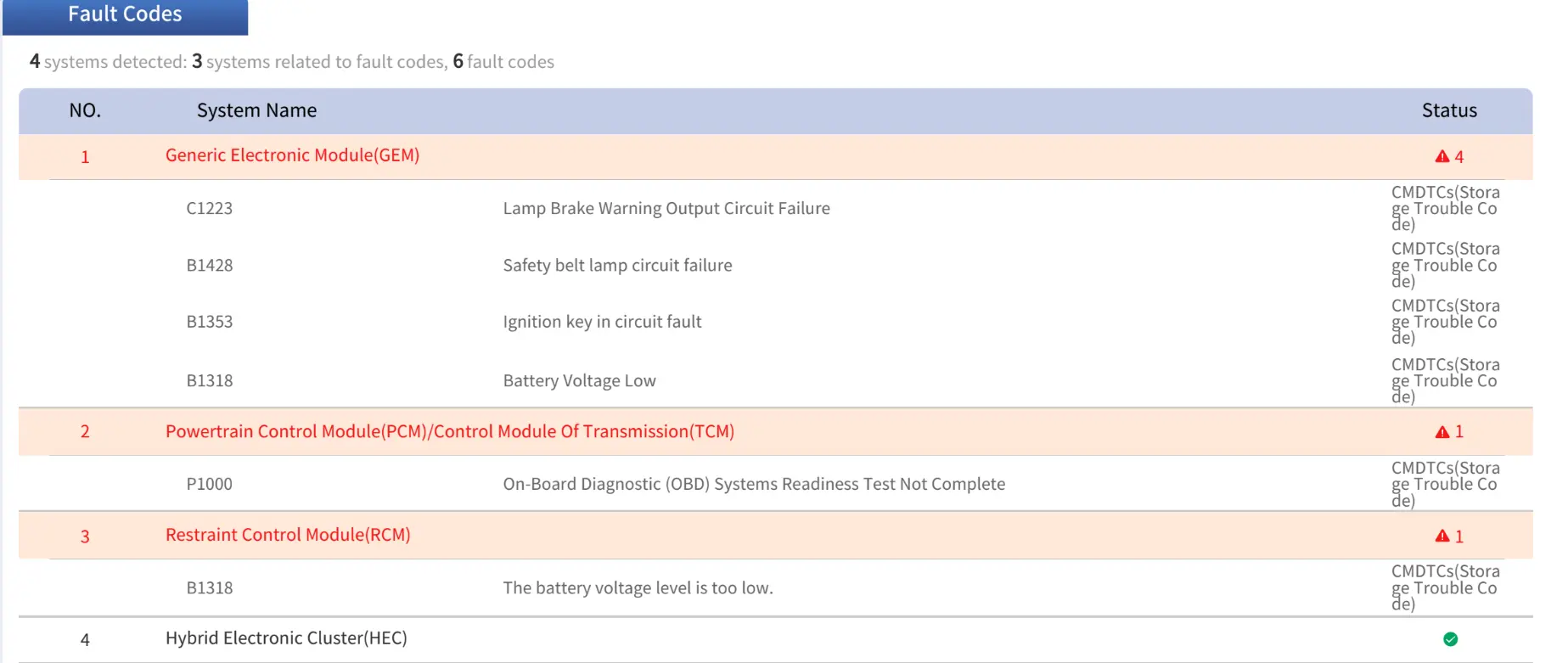

Going to check out the link to the article you sent, thank you. As for codes, I'm not sure I have any recent codes due to the car sitting for so long not connected to a battery. Not sure if the ECU has anything recent, but anyway, these are the codes that I got
I think that B1353 might be part of the problem. Google that because it sounds like your starting issues.
The B1353 Ford diagnostic trouble code (DTC) refers to an issue with the Ignition Key-In Circuit Open. This code indicates that the vehicle's computer has detected an open circuit in the ignition key-in circuit, which is responsible for detecting whether the ignition key is inserted in the ignition switch. The ignition key-in circuit is crucial for various vehicle functions, including starting the engine, enabling accessories, and preventing theft. https://www.engine-codes.com/b1353_ford.html
It honestly might be the root of my issue. What would be the next course of action?
