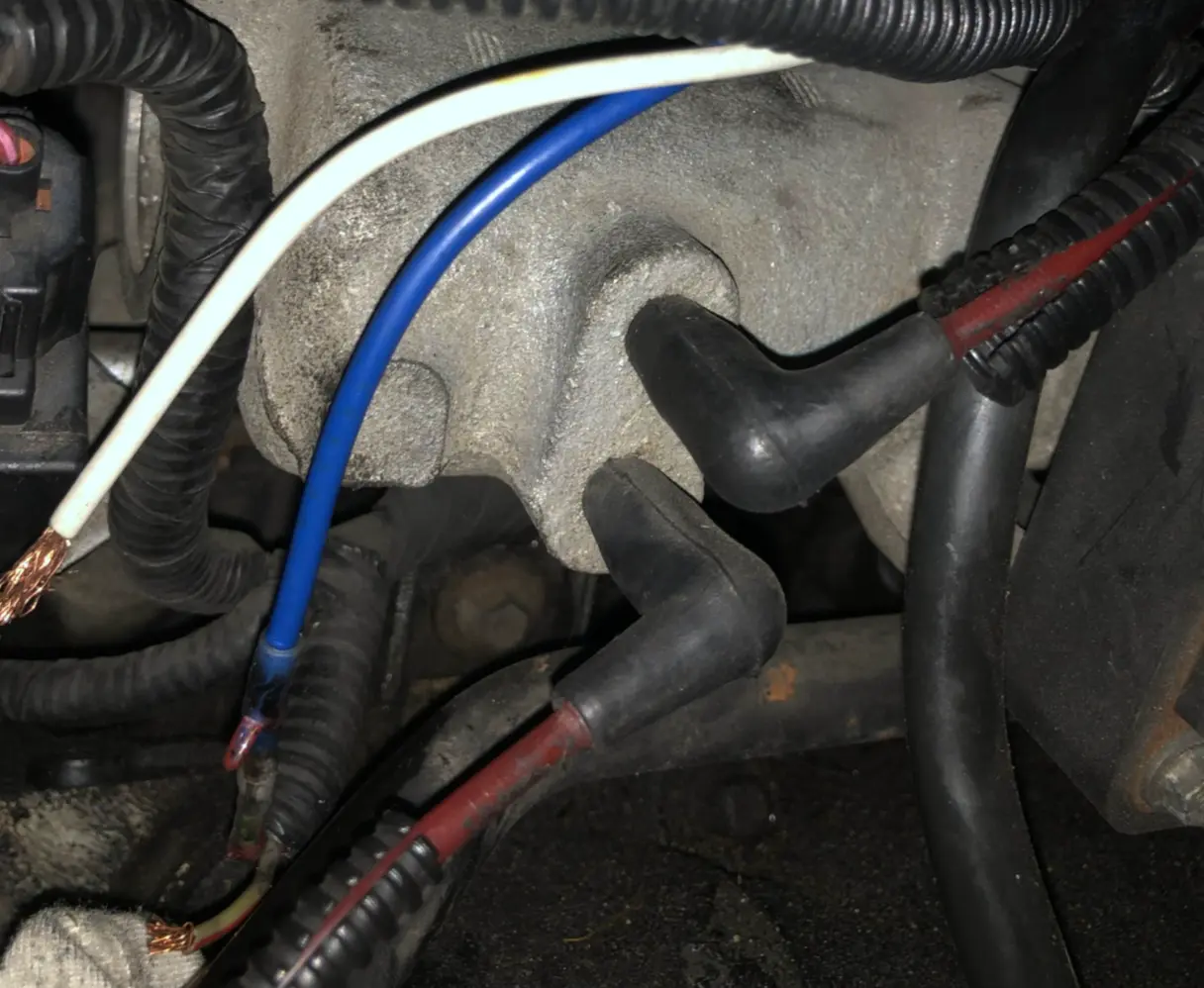

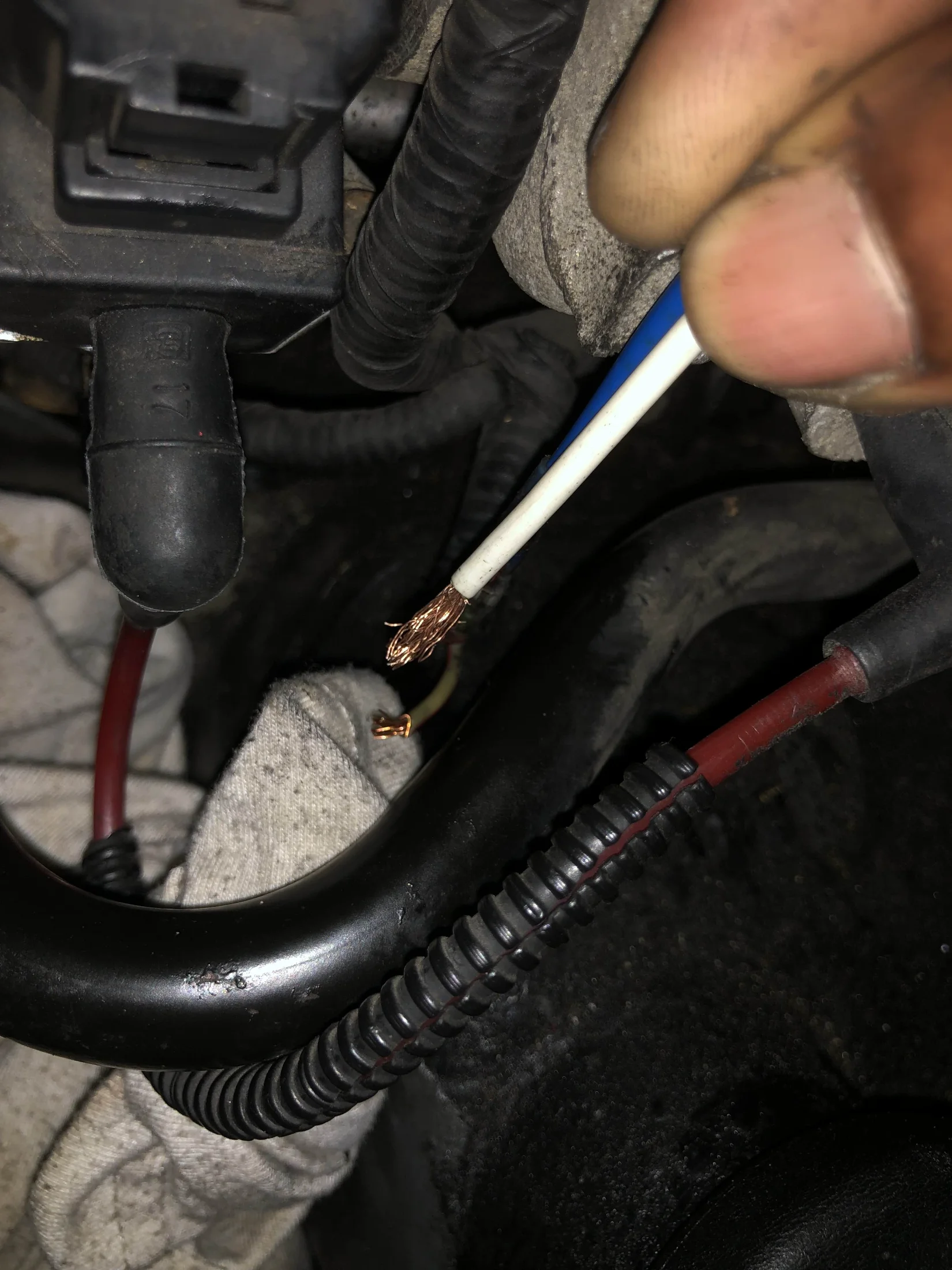

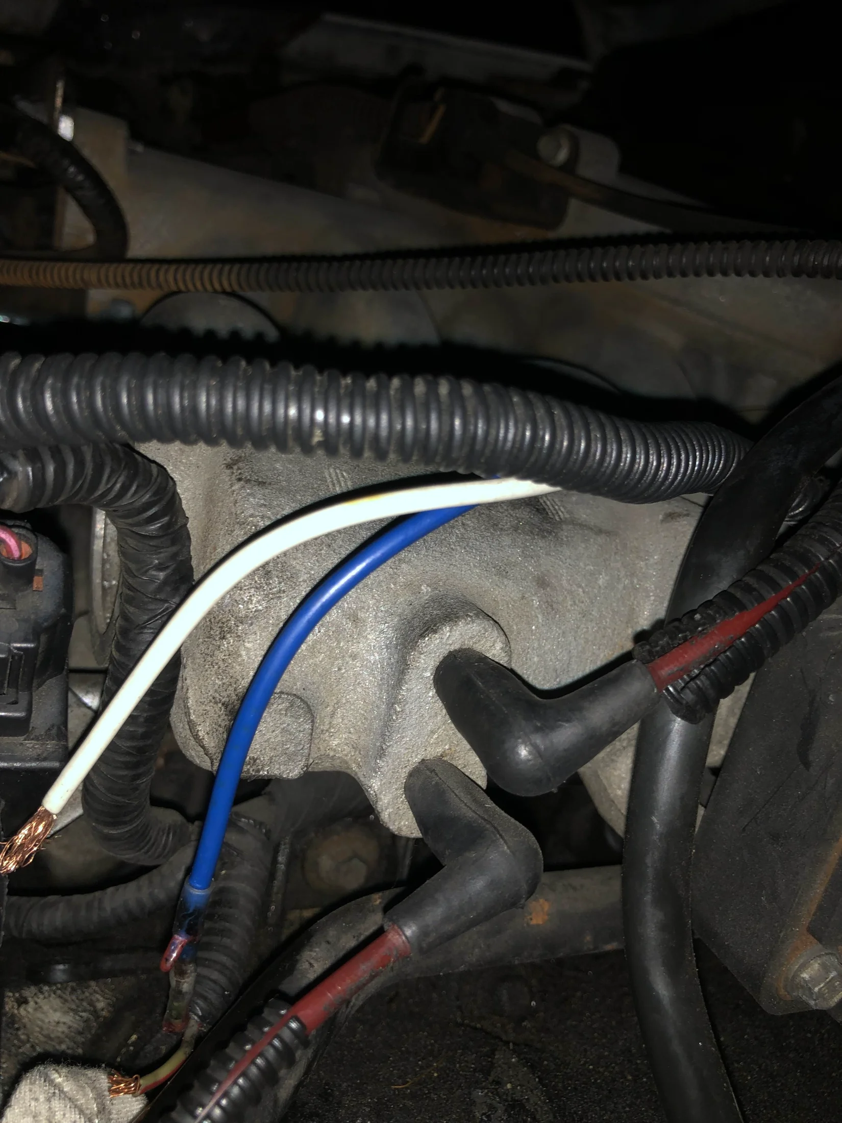

@General karthief haven't had much time to work on the car due to constant downpours, but while taking a glance just to see if I missed anything, I found out that these wires were barely being held up by the heat shrink they were in, and it was the same story with the blue wire on the side. Do you have any idea what these wires are for? They run under the intake manifold.

Here's a zoomed in pic if you can't see it well

Nope, no idea.......
Where does the other end connect to.

Can’t tell but, I can say with a 100% certainty it runs under the intake manifold can’t tell where it connects to just yet I need to get a better look at it. With a quick tug I can make the assumption that it doesn’t go too far down. I’ll take a look at it when I get home from work
