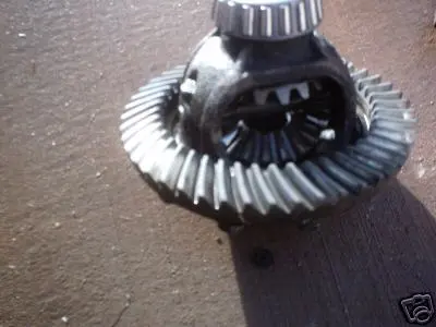

Is this for a 8"
Is this for a 8" ford rear? The seller claims that it is.
The seller is obviously confused. "Not a posi" well that goes with out saying, posi is a GM term. "Just a limited slip" yea it limits slip to one wheel :) .
Why would anyone want an open rearend with 4.11 gears?
It's hard to see a pattern on those gears, but what I can see they look decent. Throw a mini spool in there and go to town.
Most guys I know put gear marking compound on the teeth and run the gears by hand to show the pattern. The pattern should be centered on the tooth inside to out and not too deep and not too shallow.
