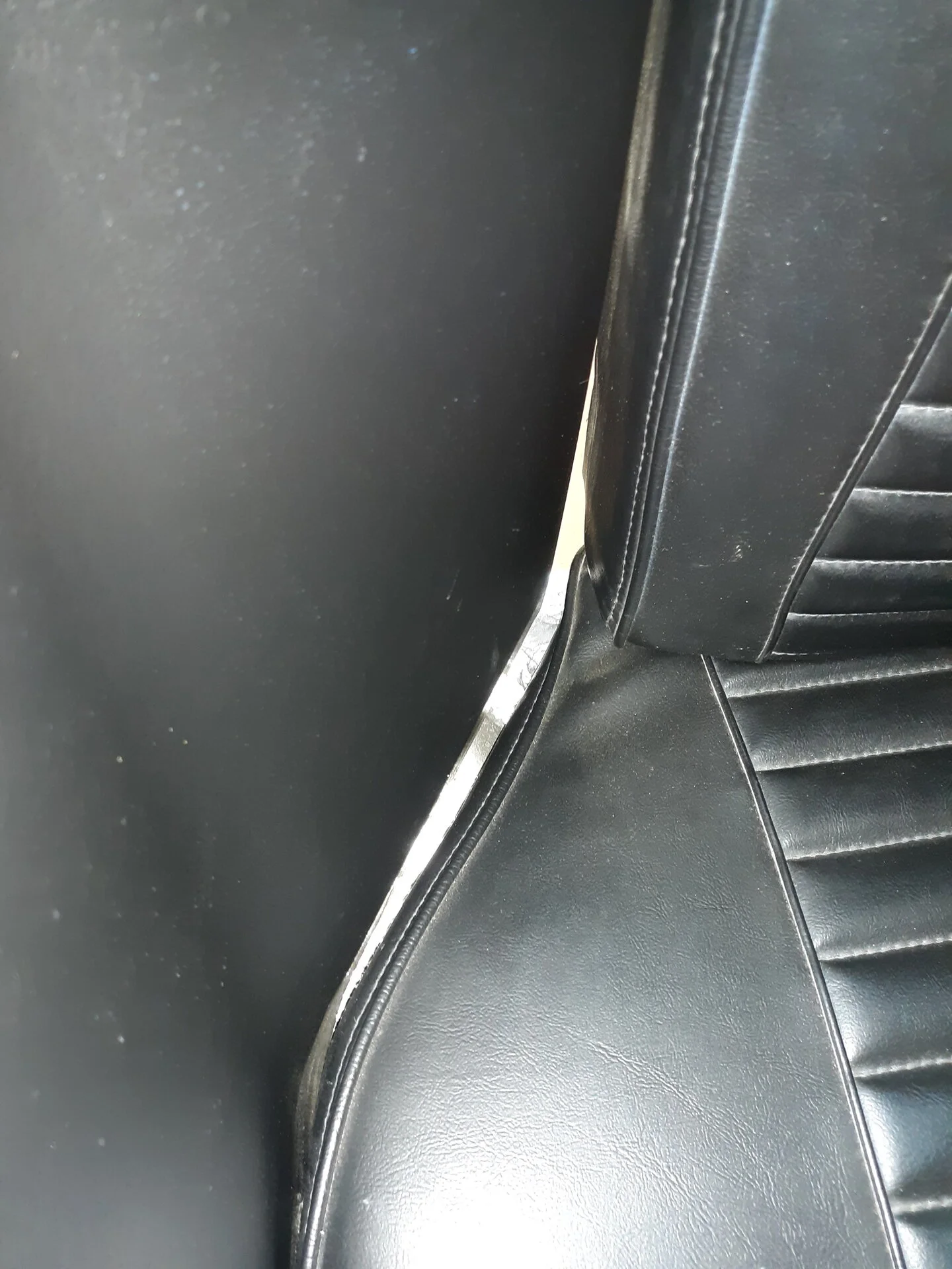

4 472viper Member Oct 17, 2019 75 8 18 Sioux Falls SD Jul 27, 2020 #1 Jul 27, 2020 #1 Gap between seat and window crank panel. Sizable gap. Thing is it same on both sides what's up ?
horse sence 15 Year Member Nov 29, 1999 12,480 8,467 233 Wile Coyote's stunt double Jul 28, 2020 #2 Jul 28, 2020 #2 Looks like when the seat was recovered it sucked the sides in a bit ,you may be able to shim the side panels out at the bottom enough to close it up
4 472viper Member Oct 17, 2019 75 8 18 Sioux Falls SD Jul 28, 2020 #3 Jul 28, 2020 #3 "shim the side panels out..." great idea !
