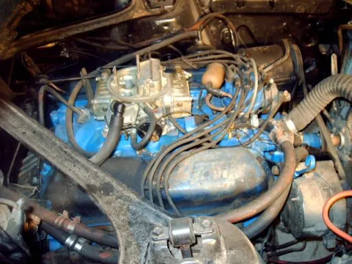

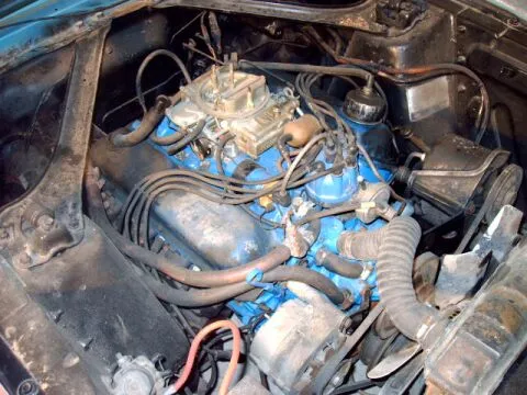

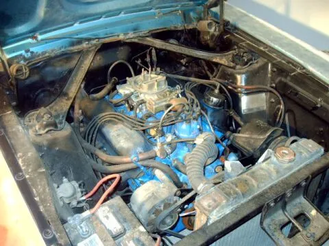

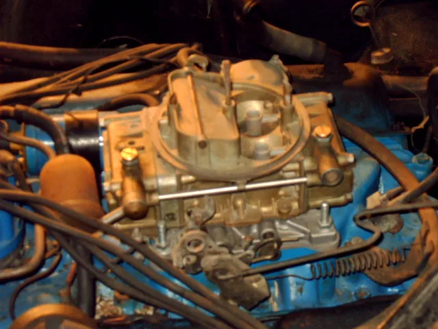

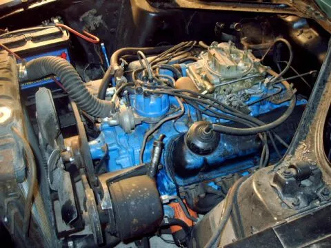

I noticed a few things in the pics, its a 4V, not a 2V, it appears to have a Holley #1850, 600 cfm carb. When you said 2V, you may have been refering to the way it was originally equipped, if so, nevermind. Also, the water pump is a post 1970 unit because the lower hose outlet is on the drivers side. I don't know why someone would have switched from the original passenger side outlet because you'd also have to change the timing cover, harmonic balancer, timing pointer, and crank pulley. My guess is that the engine is from a 70-up vehicle, which would mean its a 302. It looks like a good project, is that whats left of the original paint on the drivers side?
What are the tell tale signs of the 4V vs a 2V? He and his dad bought this car in 77 as the second owner of the car. He has never replaced the engine. So if that's not the original then the guy he got it from must have replaced it. Here's the VIN 7F01C109508. As you can see it originally came with the C code 289 2V. How can I check the motor to make for certain as to what it is? Is there going to be some kind of serial number on the block I can check? So you are saying that this motor is a 70-up 302 4V?? How good of a carb is that (looks like a 2 barrell carb though so why would that be on a 4V motor)? I don't know the first thing about carbs. I"m an EFI guy.

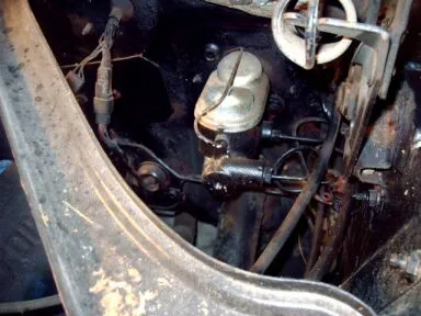

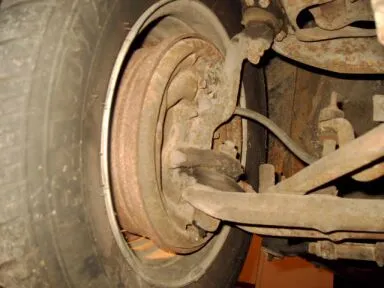

The brakes aren't currently working so I gotta figure out what to do. It's 4 wheel drums. I'd ideally like to have 4 wheel discs as well as with 5 lug pattern like the SN95s so I can run better wheels.

I'll try and attach some more pics of the motor for you guys. BTW, it is a HOLLEY carb.

ok, first off, there isn't really any difference between a 289 2V(as in 2 barrel carb) or 289 4V(4 barrel carb). Just to be sure you're not confusing valves with venturis. If you hear the modular motor guys say 4.6L 2V, that means its a 2 valve 4.6, as in sohc. When you see a term like 289 2V or 289 4V, that simply means it has a 2 venturi or 4 venturi carb, respectively. We normally call the venturi's "barrels" because of their upright cylindrical shape. If you already knew all that, nevermind, I'm not trying to make you feel ignorant or anything, I just want to make sure we're on the same page since you said you were a newb to carbs. Anyway, take a good look at your carb, then look in Jegs or Summit in the carb section, you'll see a picture of a carb just like it, and the section below will have a general description for the 1850 series carbs like you have. Note the only difference between a 2V engine and a 4V engine is the intake and carb, only exception being the Cleveland series of engines. Obviously, a 4V carb would require an intake with 4 holes, whereas a 2V carb would need an intake with 2 holes. The 'C' code in your VIN means that the car was originally equipped with a 2 barrel 289. To me, it looks like it now has 302, and the 4 barrel carb can clearly be seen. It looks like it has a Ford cast iron intake manifold, which would be better used as a boat anchor. Since you said its been sitting for 4 years, I'd definately rebuild that Holley carb, they don't like to sit. There are plenty of books available and rebuild kits are inexpensive. If I were you, Id' get a book and a rebuild kit made by Holley(the Holley kits are higher quality than the rest). Get a bucket of carb cleaner to let everything soak and get thoroughly clean. Read your book before diassembly and closely during re-assembly. By the time you get it put back together you'll know alot more about carbs.

The bolt pattern is the same, it's the backspacing on the wheels that is different. On modern cars the backspacing is more so that the brakes ride basically in the center of the wheel. To use a stock modern wheel, say like the bullet wheel, you'd have to get I believe a 1" adapter plate to bolt onto your drum and then bolt the wheel to that.
As far as brakes go, try to pick up a set of 70+ drum spindles, as they are much beefier than the ones you currently have. Then your choice for brakes are endless... there is the Granada swaps, I've heard of lincoln ones as well. Or aftermarket through companies like Willwood, SSBC, MP Brakes and Baer.

302 Coupe: Like I said earlier I don't know jack about carbs so you were right. I was thinking 2 Valve and 4 Valve. Not the Venturi thing. I'm used to the EFI motors, lol. So are you positive that's a 70-up 302 in there? Is there a number on the block that would tell me one way or another? I'll have to get those cam specs sometime soon.
Also when I get a different intake would that HOLLEY be a good one to keep or should I get something else?
:spot:
I'm not positive its a 302, I am making an educated guess based on the style of front dress it has(water pump, timing cover, etc.) The only certain way I know to tell is by looking at the casting mark on the crankshaft. The block, heads, intake, all that stuff interchanges between 289's and 302's so their part numbers may not accurately designate it as either. Like I said earlier, don't make a big deal about which engine it is, there isn't much difference between the two. I would go so far as to say that someone could steal your car one night, swap one engine for the other, then return the car, and when you drove it the next day, you'd never know it happened.
The carb you currently have will be a decent one to keep for most mild buildup's.
