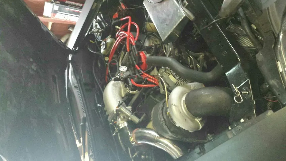

750hp from a completely untouched 1996 351w shortblock from an F250.
Reactions: madspeed, 90sickfox, TOOLOW91 and 1 other person
