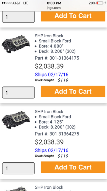

To my understanding you can order the dart just like you can order a boss block where they start with a 4.000 bore . Or you can order the big bore version which the bore starts at 4.125 . Don't quote me on that but I believe that's how it works .
Correct.

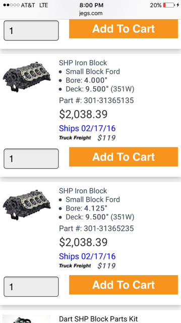

That is incorrect.8.2 is the deck width of the block . 9.5 is the deck width of a 351 hence why you'd need a new manifold if you went 351 either way.
Stock 351 and 302 bore is 4.000 if I remember correctly . You can get a dart shp with that that bore size or in a 4.125 big bore which is what I have and that's how you'd get to the 363 .
And I am most deff a giants fan
The number is a reference of deck height from the center of the main. To the head mating surface.
That's a funny flub.That is incorrect.
Learn something new everyday . I stand corrected . Either way the intake in turn is bigger .That is incorrect.
