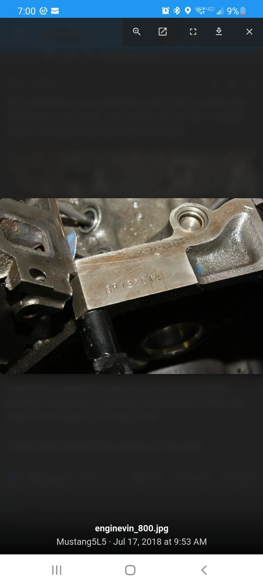

You want to check on the block behind the intake valley. There's a flat spot that should have a partial vin stamped in it. That vin should match the cobra vin.
Credit @Mustang5L5 for this pic...
