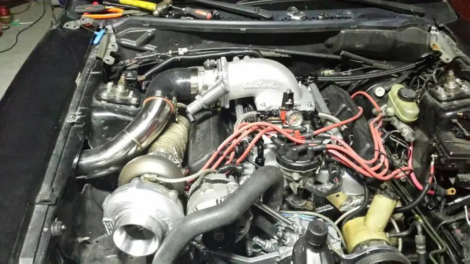

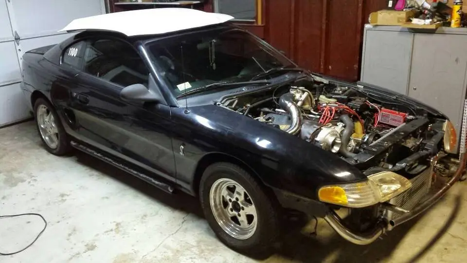

Ask any questions you might have. I've seen a lot of 351w stuff popping up lately.
1994 Cobra
1996 F250 F4TE stock shortblock
195cc AFR Renegade heads
Lunati Turbo cam
Super Victor intake
900cc injectors
eBay 70mm turbo
8-10 psi on wastegate pressure only
Built 4r70w electronically controlled
Tuned W4H0 PCM (stock 94-95 auto pcm)
565whp through a slipping converter and a conservative tune.
Reactions: 85rkyboby
How fast is it?
By the time I got here finished up this year, the track was closed. Gonna have to wait until after April 1 next year.
I feel the car is capable of a 9.90, I'm aiming for low 10s (10.01 to 10.3), but I'm expecting a 10.9 to 11.3 when I first get it out. The suspension needs to be dialed in for the new combo. Big time weight changes recently. Went from a 418hp N/A 347 with a 5 speed, to this.
Also, boost is still low, as I do not have a boost controller installed. Also, the eBay 70mm isn't staying forever. I'll be swapping it out for a PTE 7075 or 7175.
Final goal is ~700hp on E85.
