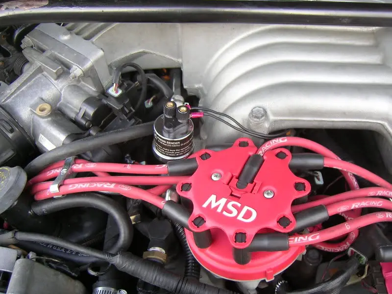

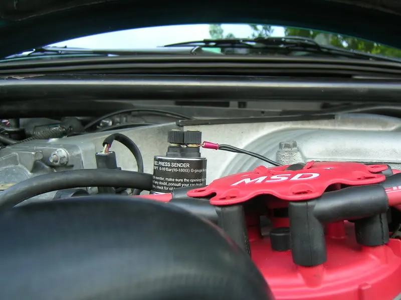

Its big but it works dead on! and it doesnt look so bad under the hood. And my dog was trying to eat it, lol. Shes so damn nosy. But i Have had it on the rail for a thousand miles now, np. Just got back from vaca, no problems the whole trip there around and back. Funny watching it starting in 30* temp, was a psi or 2 low then on warm up was fine again. Anyway Mine is also large in part I guess because the sender and guage I only paid 45 bucks for. And might I add, a bad ass gauge too. lol. Everyone loves my set up- I will have to get pics for you guys.

I thought it might have been from an older model. Make sure to get pics under the hood.

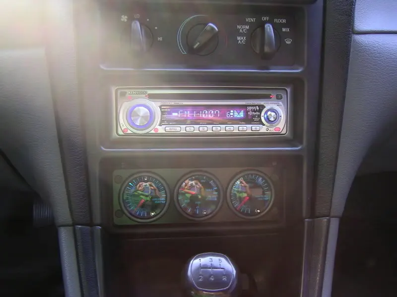

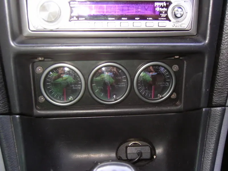

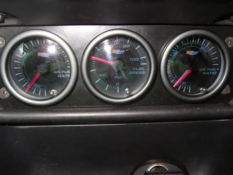

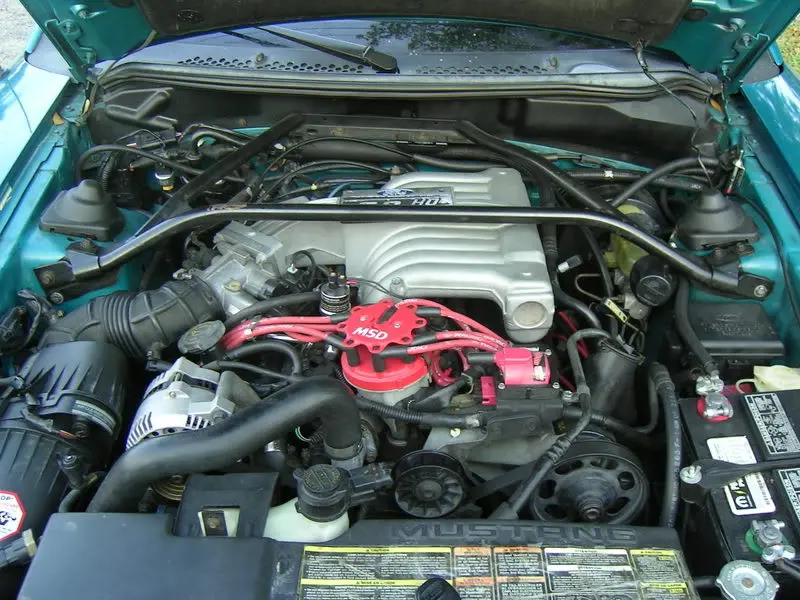

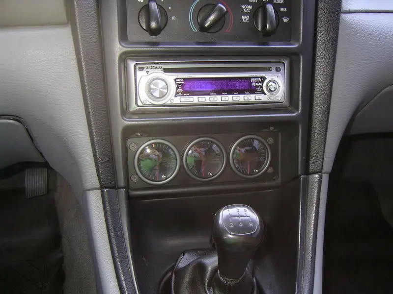

Well here are the pics all together as requested, lol Pardon my dust just got back from 1000 mile trip so car is filthy and so is engine bay. Ill wash whole thing sometime during week.
I love them, they have 7 color settings, Have them on teal to match car. And the are full sweep fully electronic and have a tinted lens so when they are off you cant see whats what, lol.

Nice looking setup, but what is with the two A/F gauges?
Zero Signal
Feb 24, 2003
2,633
46
Tucson, AZ
Mar 15, 2008
#17
  • Mar 15, 2008
  • #17
Left bank / right bank?
GTA_V6_Mustang
Nov 29, 2004
1,326
39
Miami, FL
Mar 15, 2008
#18
  • Mar 15, 2008
  • #18
correct
