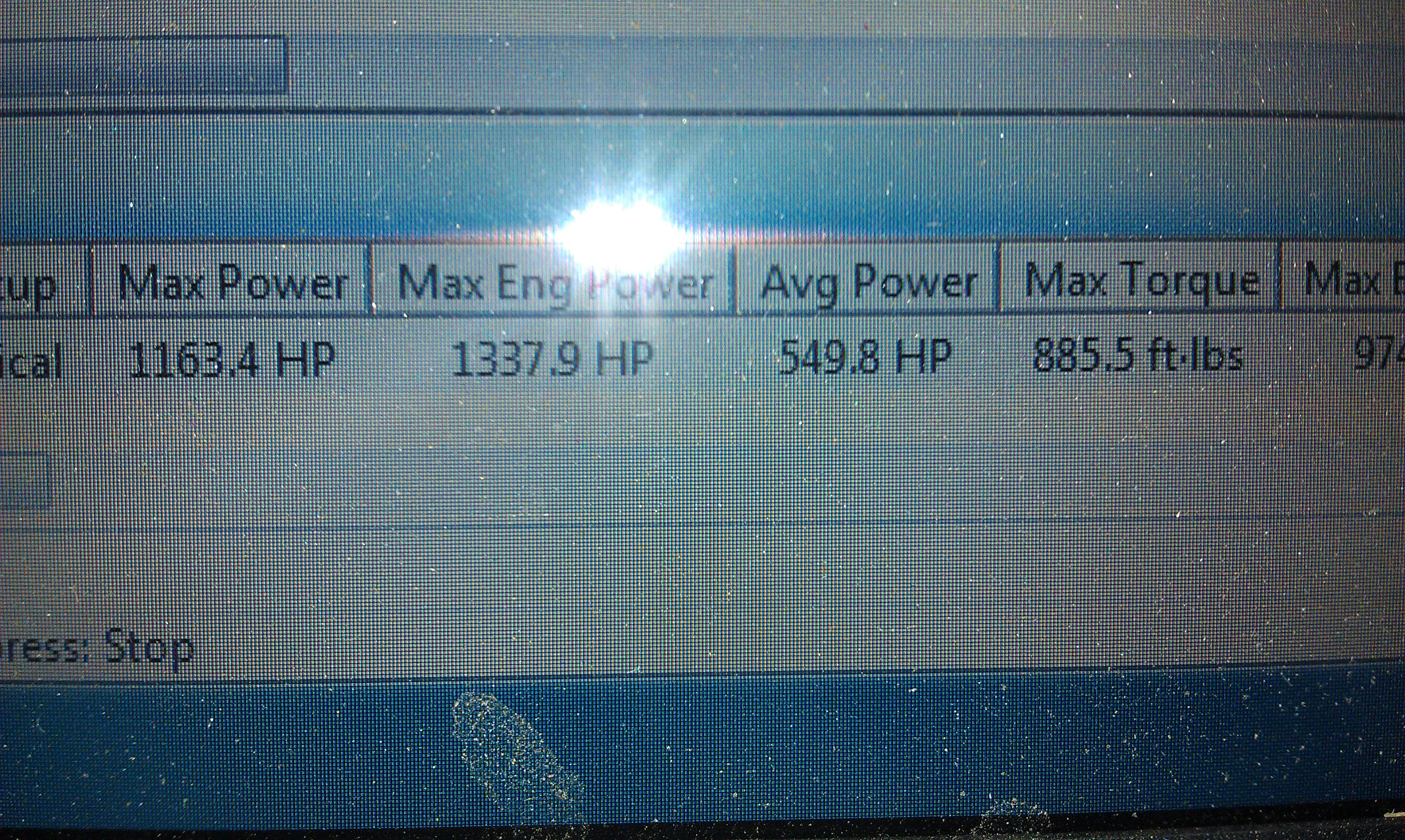

Here's the update:
We got the new convertor from cameorns the other day and popped that in with no trouble. While we had the car down for a few weeks I decided to sent the heads out and have inconel exhaust valves put in them and a few other odds and ends done.
Long story short we put it on the dyno today and made 1163 rwhp. As soon as the video is edited a little ill post a link to that. We spun the rollers to 184 mph!
One correction must be noted since dudnotch joe is reading nicks typo, so far ALL these pulls where with a v24 Xtrim, 21.6# was peak boost with it leveling off to 20# up top on the datalogger. We have one of 2 XX volutes Vortech released for test data for this same head unit that we still have to put on this week which should yield another 100rwhp or so, then I also have an XB105 and a ztrim deciding which to try..... it made 1163 with no ice in the cooler .... theres the facts.
so you are admitting the owner of the car said it was a ''double X TRIM'' and you had his posts edited, cause it was a ''TYPO''? nice attempt on trying to over up your underachiving nugget with a claim of having a smaller (now) ''single X trim'' as to why its under powered............ sorry to say but that is a EPIC FAIL making that kind of power with a engine over 430+cubes with heads that flow WELL OVER 330# when there are 8.2 deck 302 base engines making more HP with small YSI's ... lmaoooo.

Nick got this blower from me from my underachieving 331 streetcar that went a best of 8.6 but usually 8.8's with the XX volute... It is a Xtrim unit stamped right on the tag. Vortech never made a XX for the public but did make a XX volute since the impeller and cases are the same. I have one and kurgan has one as far as i know. The v24XX flowed roughly 150cfm more than the v24X with a little less efficiency than the Xtrim which was good for @ 100rwhp. The Xtrim is rated for 1300hp and the XX to 1400hp so they are pretty similar. We have been dynoing with the Xtrim so far to see what it would make and for data to compare against a couple other head units Vortech gave me to test. I personally wanted to see the difference between the X and XX since i only ever used the XX volute on my small motor so we will swap the volute before going to a bigger head unit. This car will cruise around here hit some shows, meets, and races and times will always be posted this is no grudge car so there would be no reason to care what blower it is we could put ice in the cooler, turn up the timing with some c16 or q16 and make more power i know but thats not how it will be raced so no point. Since you obviously build better setups for streeters i hope to see one of them at a true street race this year and see it resetting the record into the 7's since noone with a ford has been able to do it after actually driving 30miles and hot lapping 3 passes without opening the hood or touching anything. You would enjoy the class no wheelie bars, no slicks, no backhalves, etc... and real streeters like nicks going as fast as they can. Hope that answers any questions you might have had and lets you move onto cyberstalking someone else's builds. Good luck this year with your grudge stuff either way.
