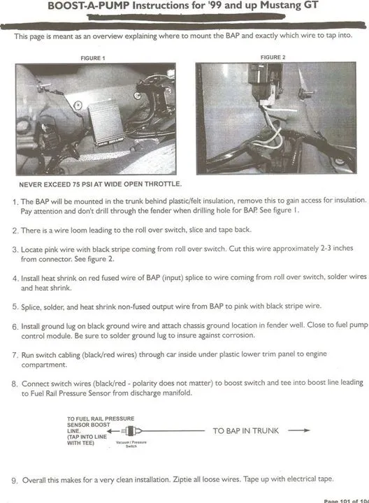

When you run the electical wire to the front of the car, where is it supposed to connect to? I've been having an issue where there is draw on my battery when the car is turned off, and if I don't keep it on a battery charger when I'm not driving it, it dies in just 2-3 days. I believe that the shop who installed my BAP wired it directly to the battery instead of to the fuse box (I'm not home right now to verify, but 99.9% sure), and I never received the install instructions to validate the work. Can someone please point me in the right direction as to where this wire is supposed to connect to; if it's the fuse box, can you point out which fuse and the amp of the fuse needed to make sure this thing is hooked up properly? Thanks!
Side note: I had an issue earlier where my radio was shorting out, so I just removed the fuse for it. After removing the fuse for the radio, there was still a slight amount of draw on the battery while the car was turned off - the only thing electrically that changed was the BAP install.

HTH.

Thank you! I'll check it out (hopefully) this evening!
