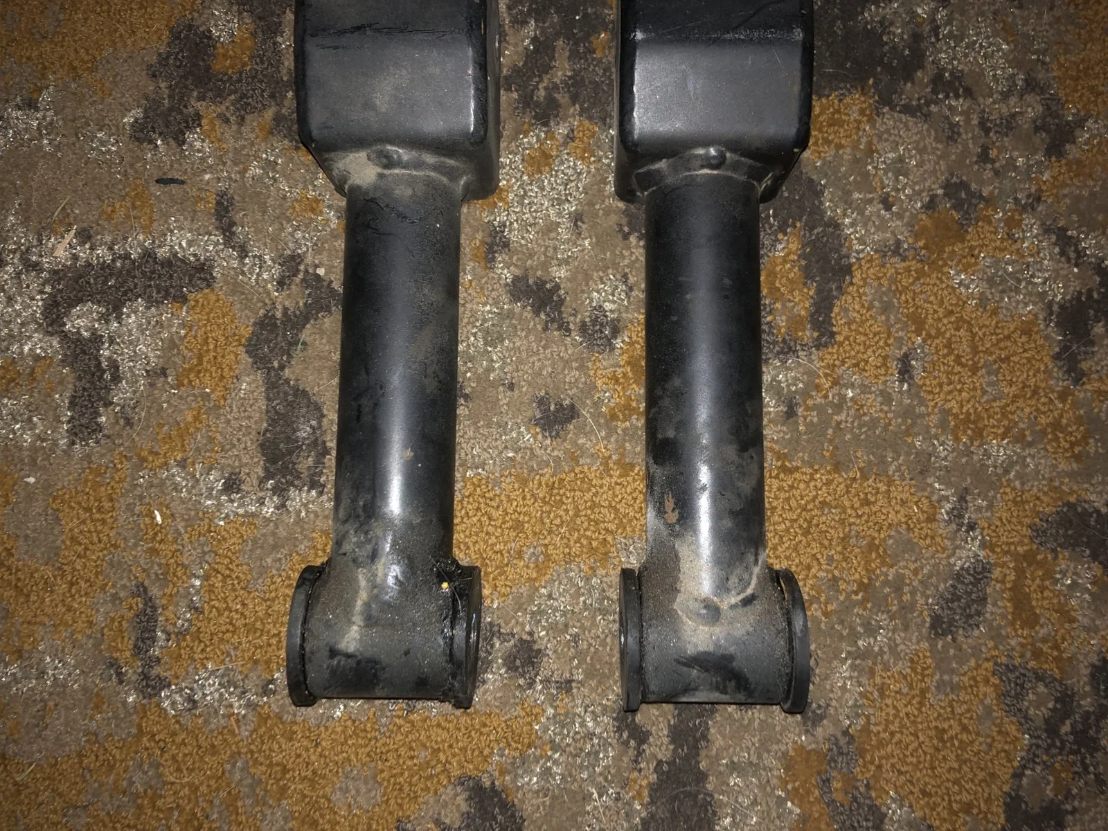

However, the past year there has been a knock in suspension when turning. I thought the exhaust hanger gave up and the dumps were hitting.

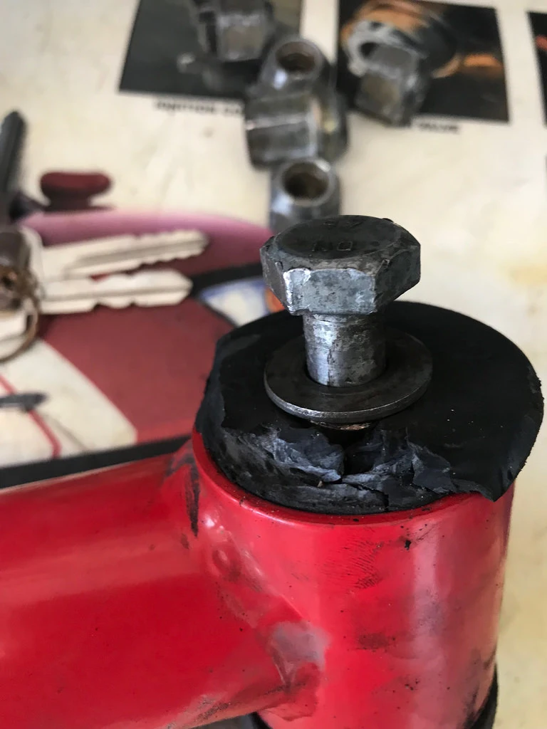

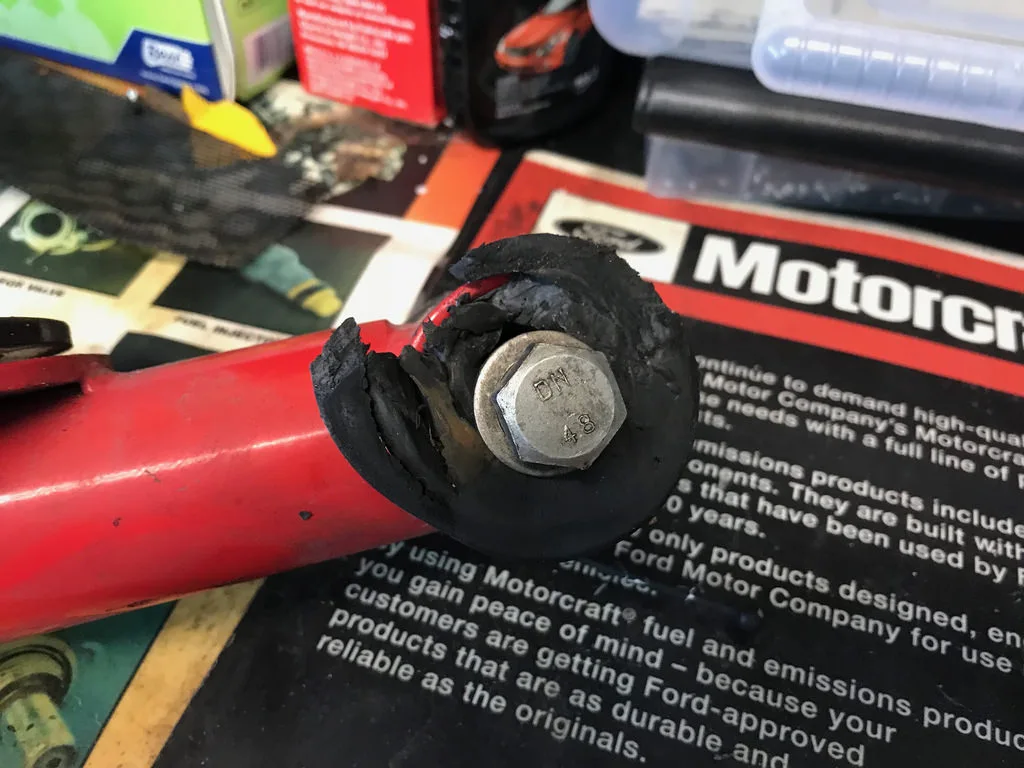

Fast forward to earlier this month the car felt loose randomly and almost lost control otw to the grocery store under normal acceleration.

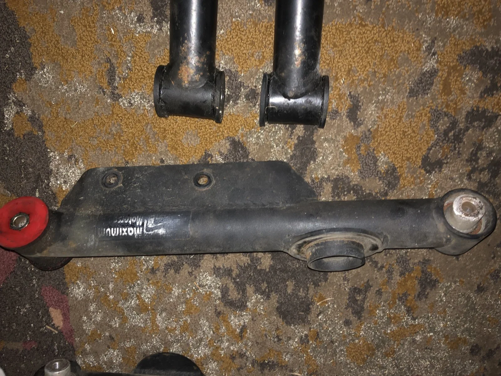

Took the car down and apart and yes I know I shouldn’t of bought the LMR/AM/CJ Pony $100ish control arms but this kind of ridiculous.
View: https://youtu.be/GgkIeT6X9u0
Replacing with Maximum Motorsports LCA.
