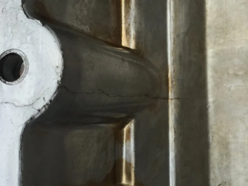

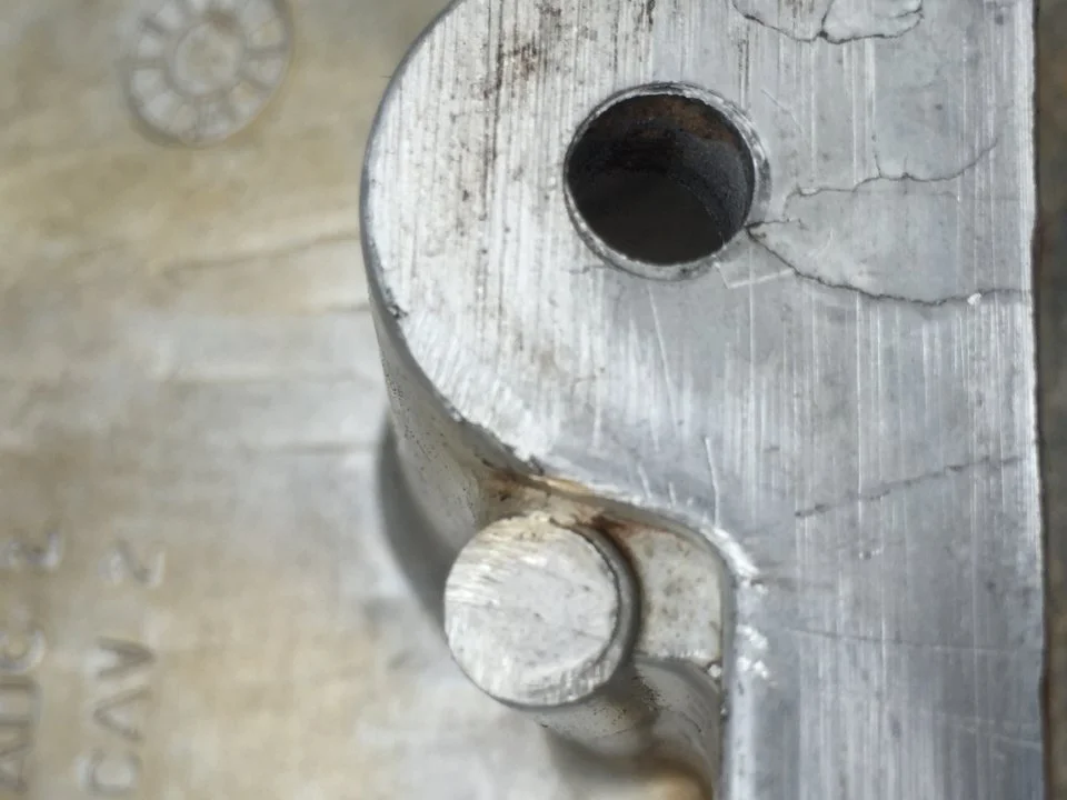

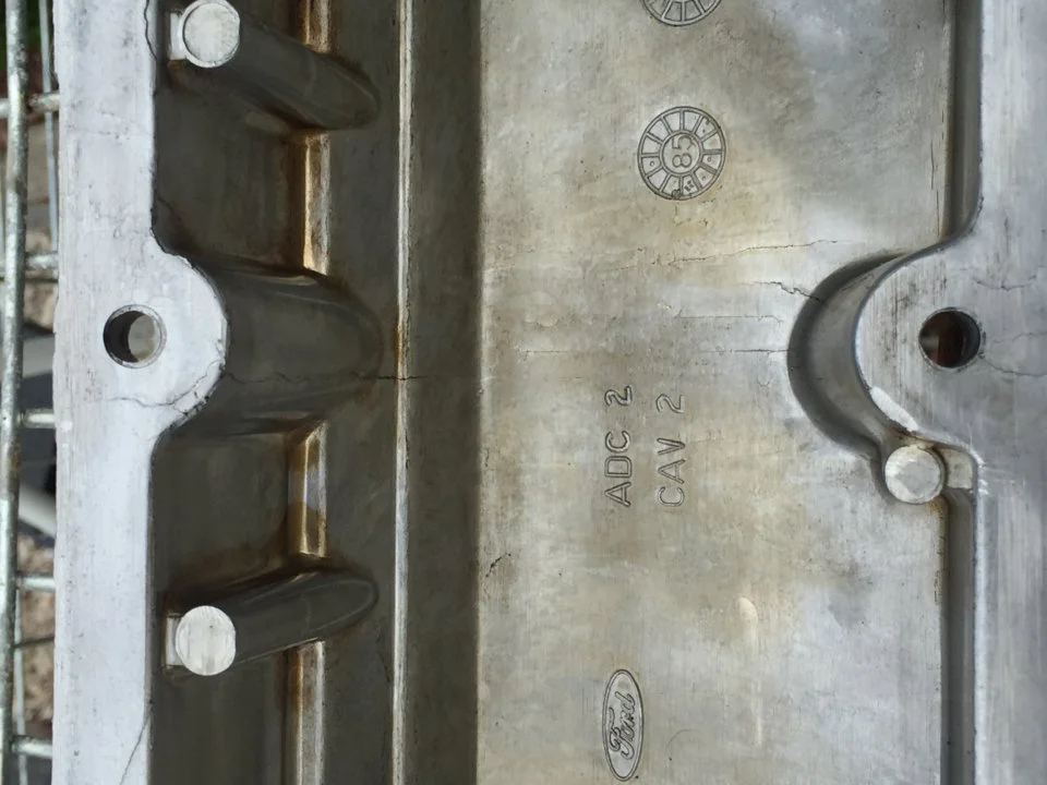

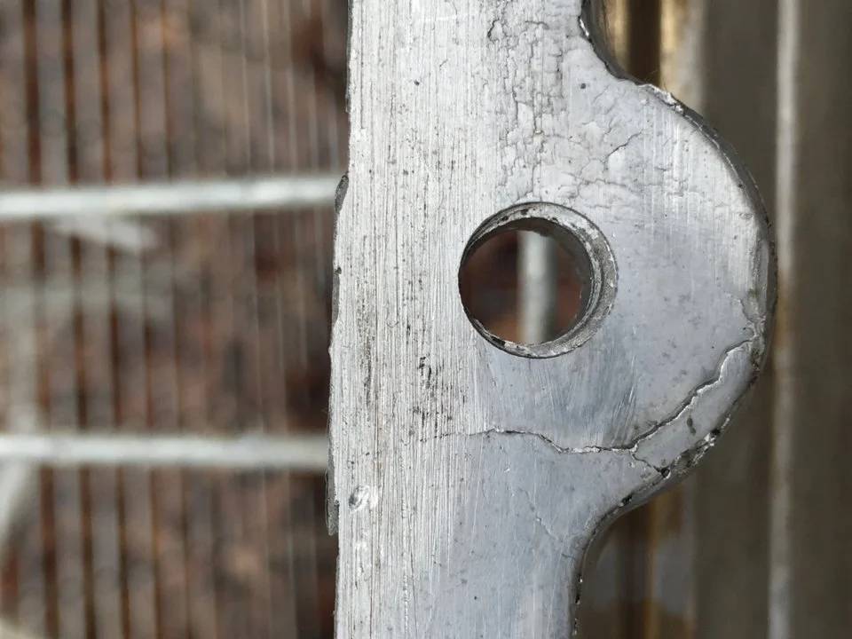

I pulled it back off. Looks like there is some fresh wear on the topside of the cover. Near the middle bolt hole. Looks like there is small cracks in it as well that don't go all the way through the the cover. Why would replacing the valve cover gasket cause this?
This is the two middle bolt holes.

any marking to the underside of the valve vover? could be a rocker touching the vc
There is one mark on the under side. When listening to it with a screwdriver I'm sure it's not the valve covers knocking. If I listen to it in the intake right behind the distributor I can hear a distinct ticking noise. My guess is the lifters or cam. Definitely in the top of the motor though.
