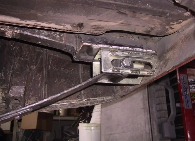

The weird thing is, these things are mounted on plastic pucks that slide back and forth - does that mean they just slide around and slam against their stops as the suspension moves? Seems unstable to me, but if they are being raced there must be something I'm not understanding. Dug up a pic:

Hello,
They weld to the frame in place of the rear shackles, allowing the rear leafs to slide fore and aft. You need to install them on the springs and then let the weight of the car down on the springs in order to locate the sliders properly. You need to leave approx 1/3 of the travel towards the front of the car (extension), and the other 2/3 of travel to the rear (compression). The stock springs will work, but they force the slider way to the back. I mounted mine as far back as I could without making serious mods to the uni-body. They ended up roughly at the mid-point. Ideally you would want the spring to bottom out before it hits the end of travel, or you're going to hit bottom like a rock, or even worse, rip them out.
Unfortunately, I can't comment on real world driving as I'm still sorting out the brakes and engine on my car. As you've seen from other replies, the main advantage is a linear spring rate, making the rear more predictable. It will also stiffen up the sideward motion somewhat, but it's no replacement for a panhard bar or watts link.
You can custom order springs from Flexi-Flyer, so you might consider ordering them about 1" shorter from the rear housing locating pin to the rear bushing centerline. They're custom parts you can't return, so mock it up and take measurements before ordering.
I'm dying to actually drive my car, but it's been fighting me every step of the way. As soon as I get some drive time I'll let you know. Before I take it to the track I plan to install a panhard rod.
As you noted, you can get them from several vendors for much less than what Cobra Automotive is asking.
