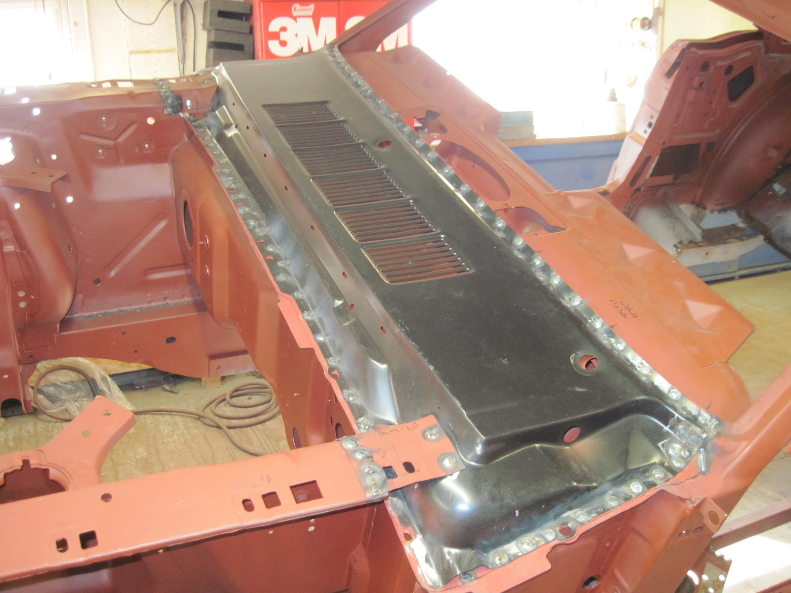

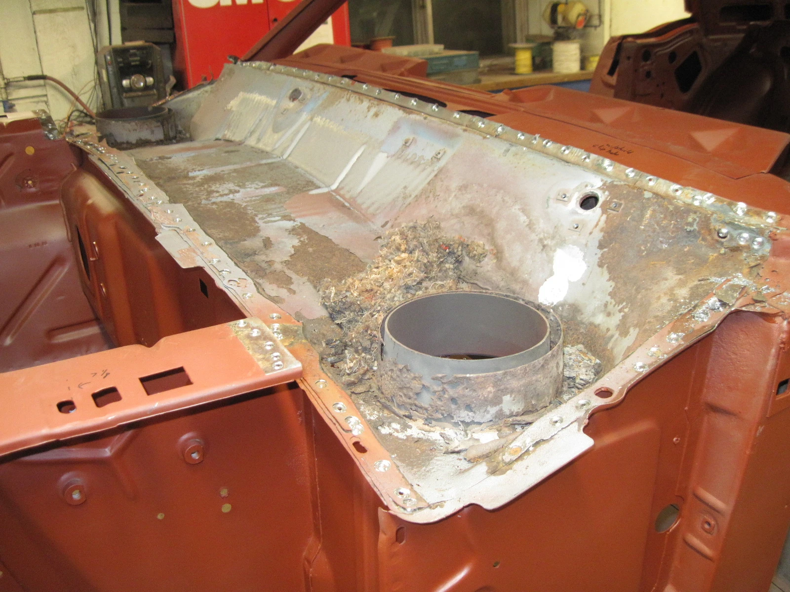

Ah yes, the dreaded cowl leak.
I had to replace my cowl to correct it.
