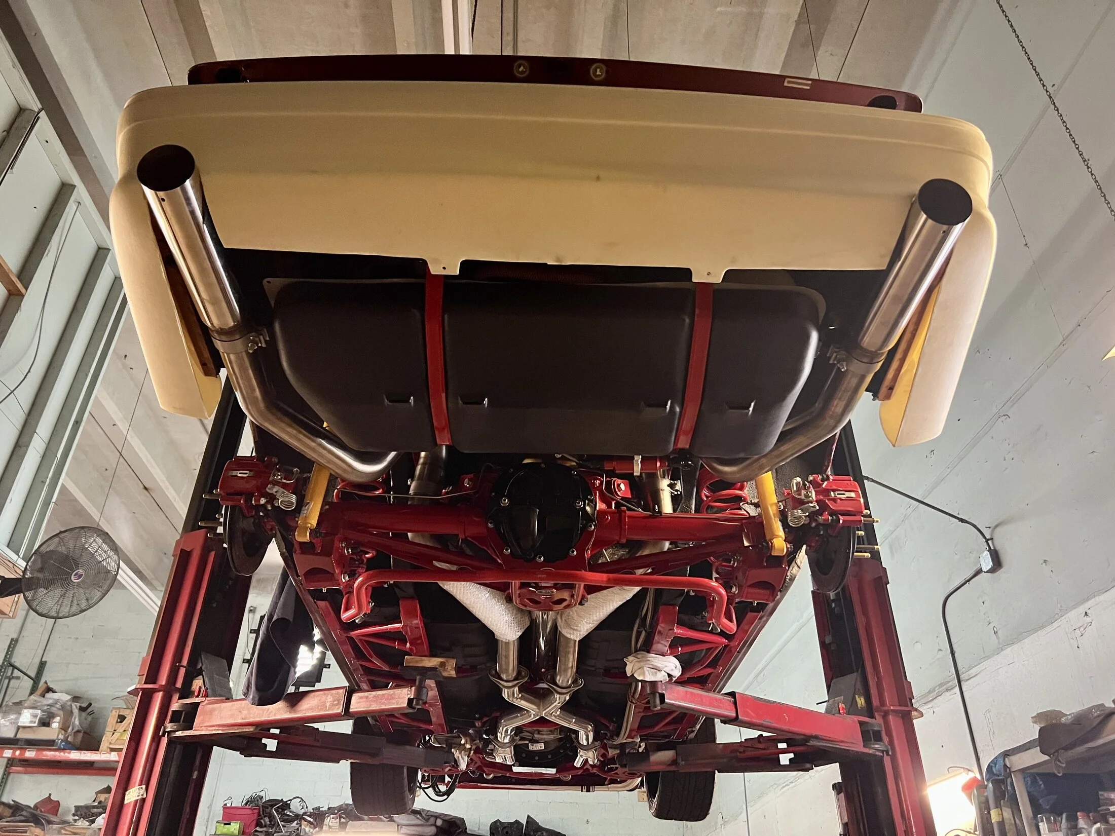

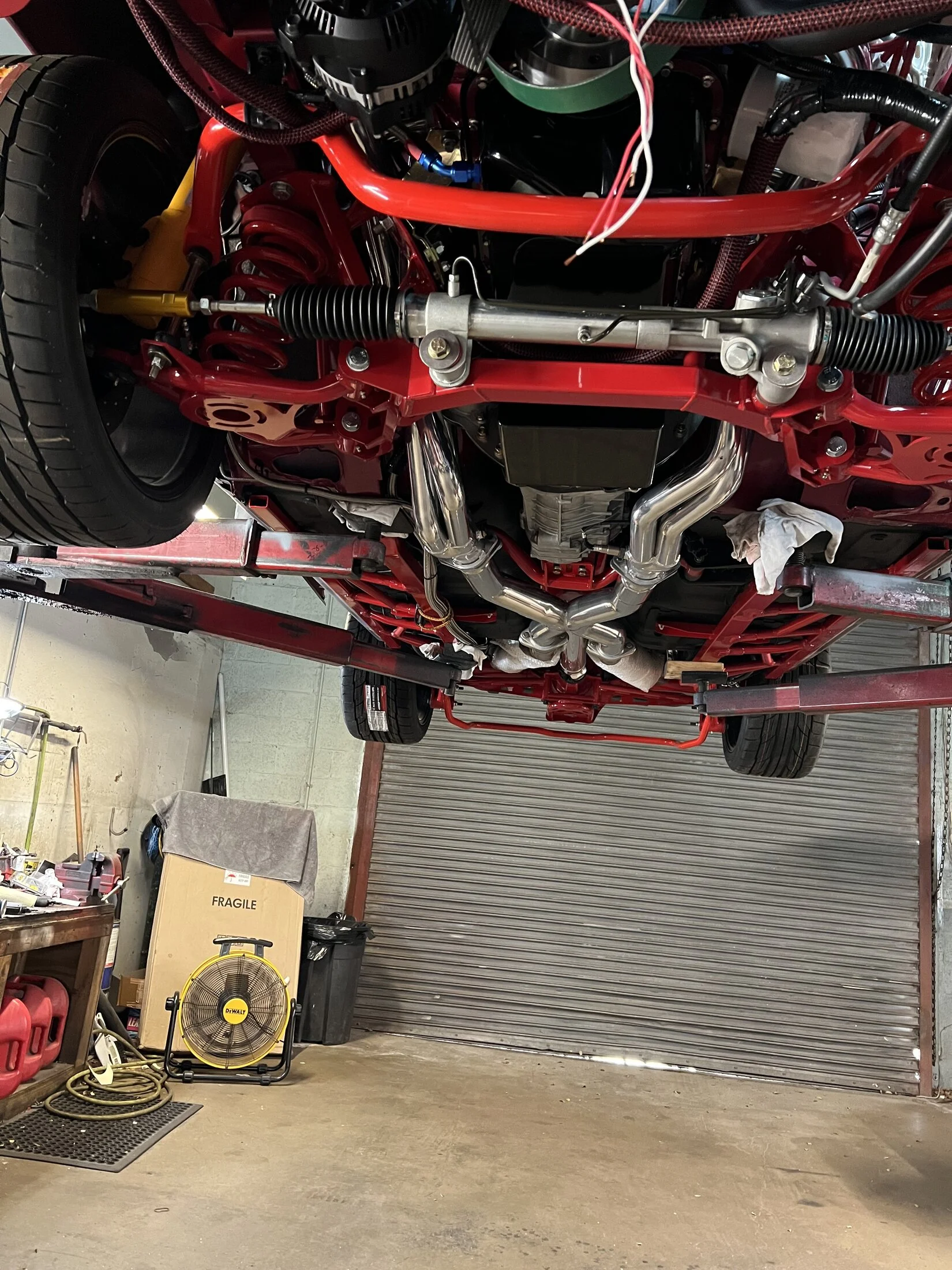

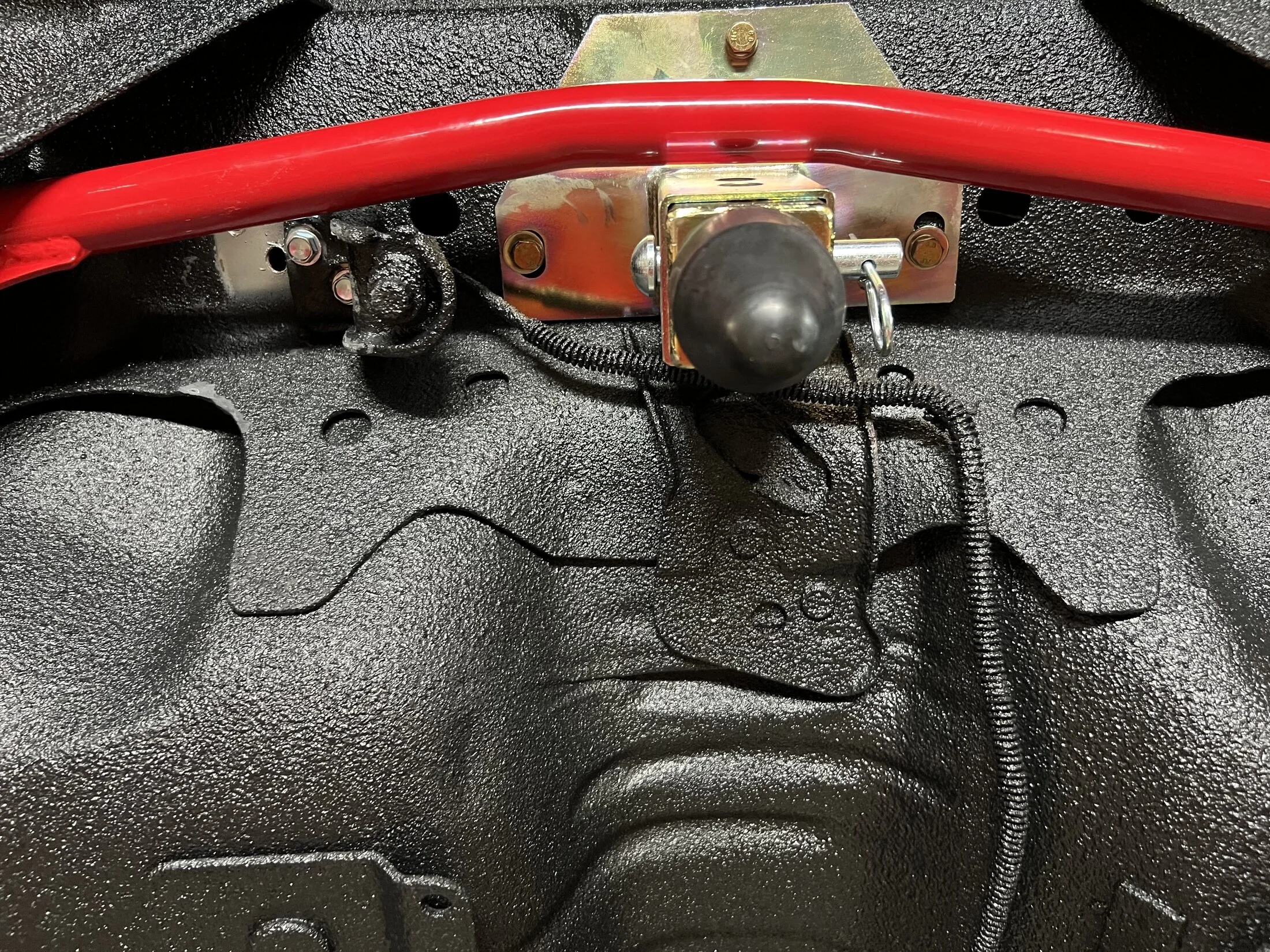

Por 15 is some really good stuff and I have used it in the past. You can always use some frame epoxy paint too which is cheaper. On my car which I’m going show, I prepped underneath and then applied adhesion promoter, etching primer and raptor bed liner. Came out nice and durable then reassembled the car adding powder coat etc.

Underside of your car looks amazing. I'm going to throw a constructive criticism at you (don't be insulted), lose the red tank straps, some parts aren't meant to be accentuated. Other than that, love what you have done.

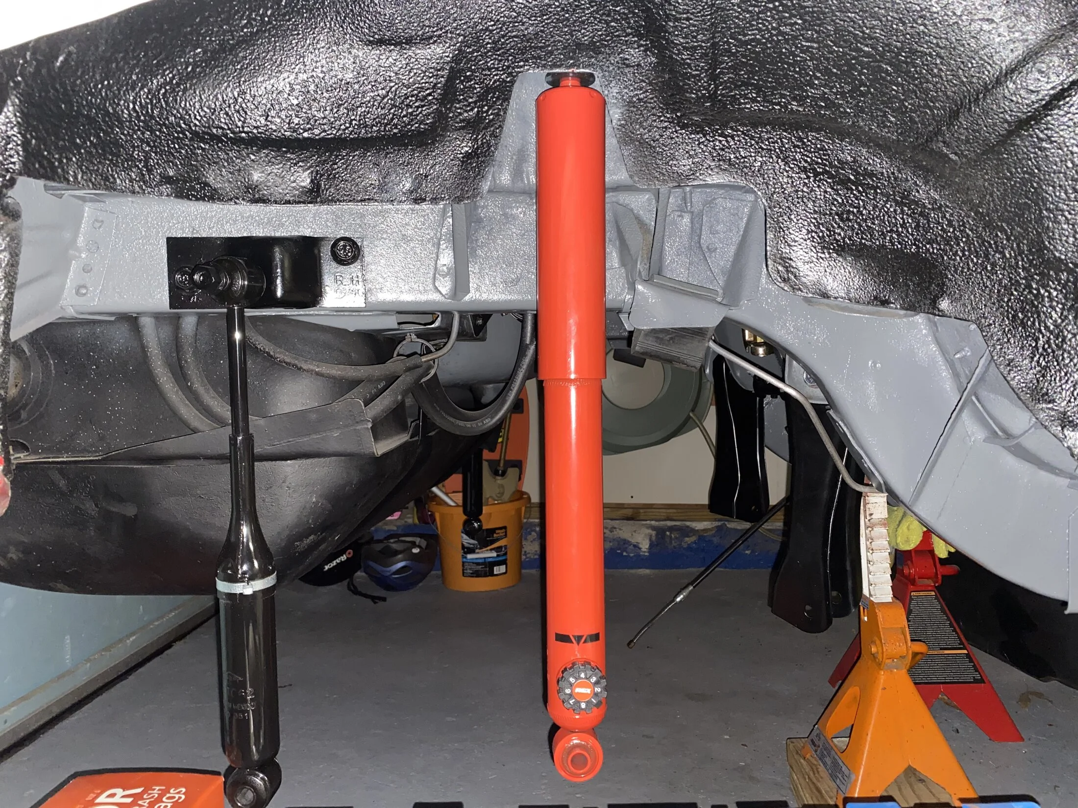

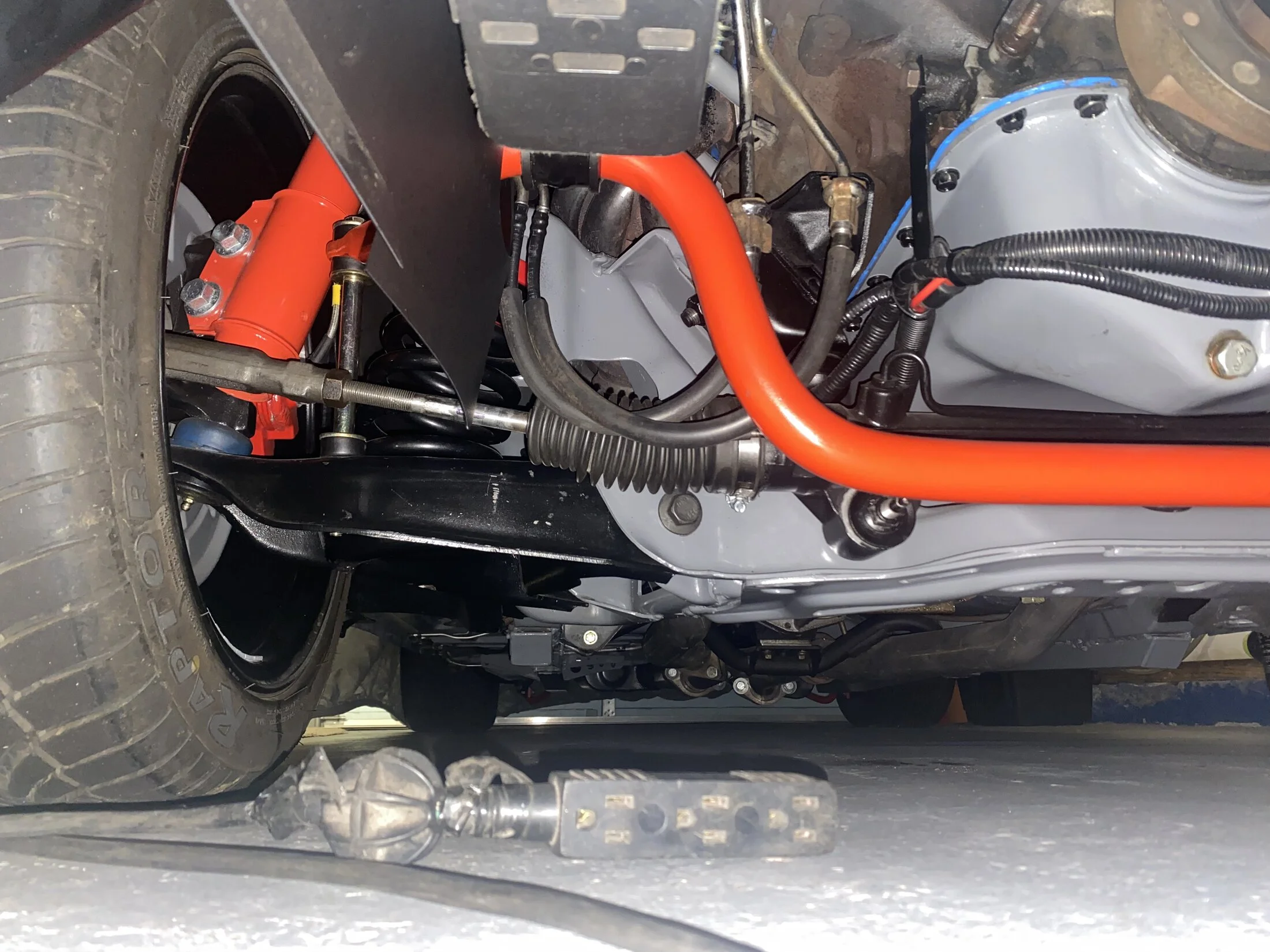

I have had some good luck with a combo of Rustoleum rattle can as well as brush on. My car sees no bad weather and isn’t driven much, but it has held up great for what I put it through. I also chose to do the wheel wells black like you mentioned. That was rattle can as well.
I will say that I cleaned and prepped everything thoroughly, and hit most of the areas with scotch bright, then primed, then paint.
