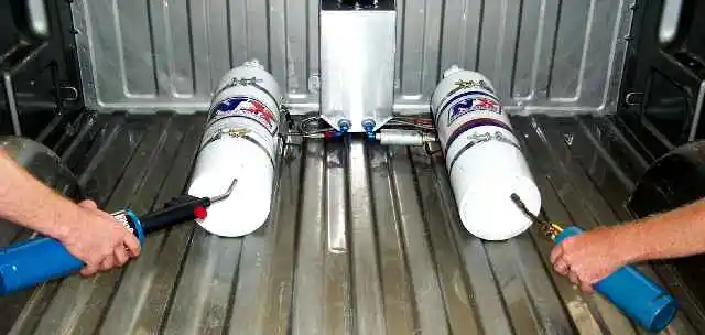

"When you get the bottle filled,freeze it and don't let them pump it in. You will be paying for air. I picked up almost a tenth in the 1/8 when I stopped pumping."
Freeze the bottle bottle before or after i get it filled? The nitrous place will let me pump up the bottle? Maybe you wrote the last sentence wrong but why did you stop pumping?? I understand that the bottle must be at 900 psi for best results, If i only have 1 lb of nitrous left in the bottle, how the hell is it going to be 900psi? Is it still pressurized to the last drop?
ps i found this on google, this can't be safe....

Freeze it before you fill it. You want your bottle pressure to be lower than the fill bottle. That way it is force feeding pure nitrous into your bottle. If it is pumped, normal air goes in the bottle along with nitrous and you pay for breathing air.
The bottle won't come close to reaching 900 psi with only 1 lbs. Even if you use it a the 300lbs that it might have, there is not enough pressure to turn the nitrous to liquid. Then you have the same problem as you had before when you don't purge.
