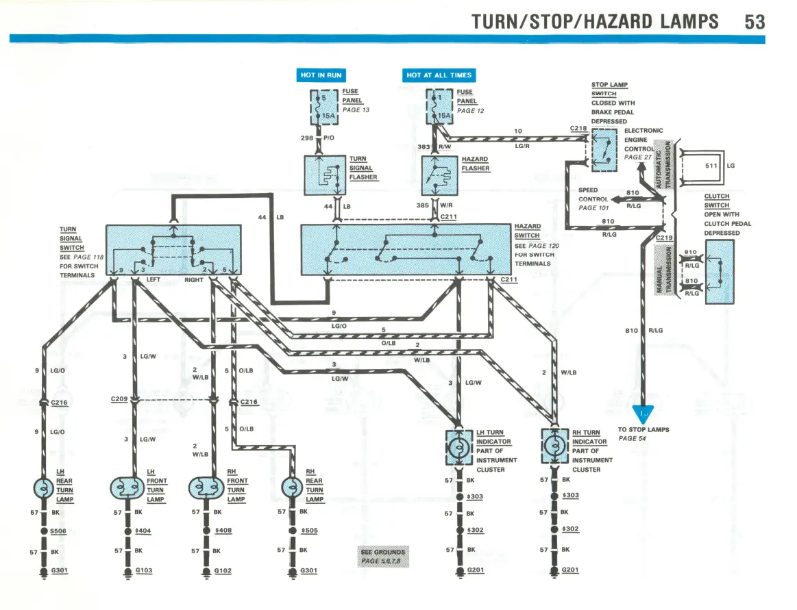

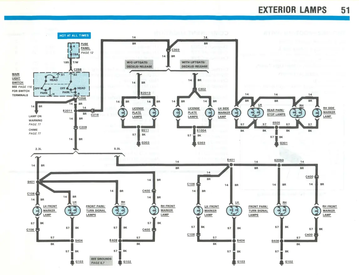

What happens when you turn on the parking lights? Do front and rear go on?
The brake and parking lights don't really share any wiring. The front and rear parking lights connect as a splice and separate, but all go through the headlight switch.
DId you try disconnecting the heaflight switch from the harness and then stepping on the brake? Do the parking lights still come on? If so that leads to a wire being cut/sliced elsewhere in the harness that shouldn't be where it is.
Stop lights are completely seperate. So somewhere there is a wire out of place or some hackery has taken place
