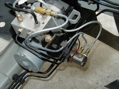

My motor is out of the car, so I will take pics of the installed line loc so you guys can see it. I do have an 01.
Starkie
See if this helps.

Don't worry, it will work properly. Follow the instructions on joe lynch's page. I installed a biondo unit from summit on my car. Works like a charm.
Great. Im gonna be installing mine tomorrow as well. The hurst directions are exactly the same as what everyone has done in their pictures, but the way it looks, it seems like it will only lock 1 wheel. Thanks a bunch all.
