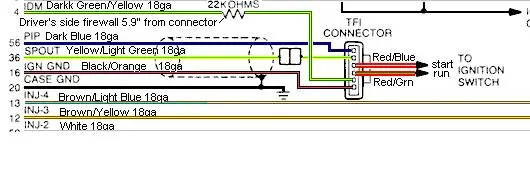

Fix the wiring problem in the SPOUT circuit rather than band aid the problem.
Possible causes:
Bad TFI module. The TFI takes the spark advance signal set from the computer and uses it to fire the coil.
Broken wire or bad connection -with the SPOUT connector in place, measure the resistance between between the yellow/lt green wire on the TFI module and pin 36 on the computer. You should see less than 1.5 ohms. Measure the resistance between the yellow/green wire and ground with both the computer and TFI connectors disconnected. You should see more that 1 meg ohm. Do not hold on to the metal probe tips with your bare hands when you make your measurements. Doing that will result in incorrect measurements. You can use a safety pin to probe the connecors from the rear.
attachment.php
See the following website for some help from Tmoss (diagram designer) & Stang&2Birds (website host) for help on 88-95 wiring http://www.veryuseful.com/mustang/tech/engine/ Everyone should bookmark this site.
The following is a view from the computer side of the computer connector.
