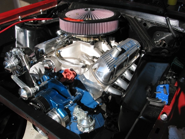

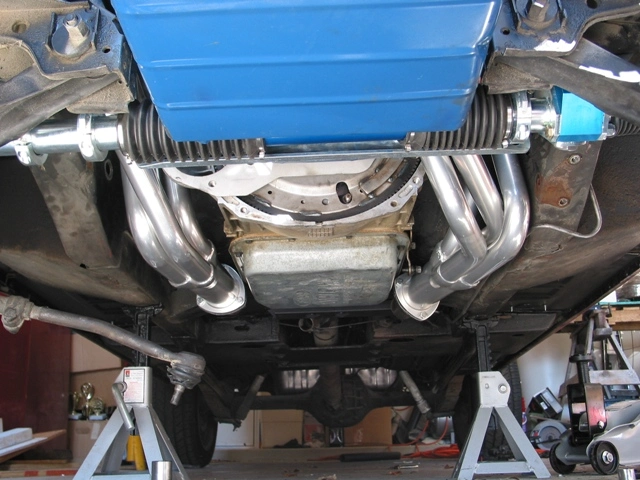

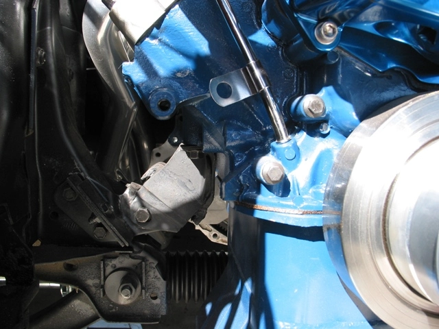

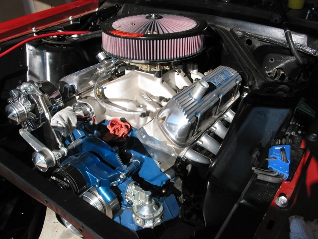

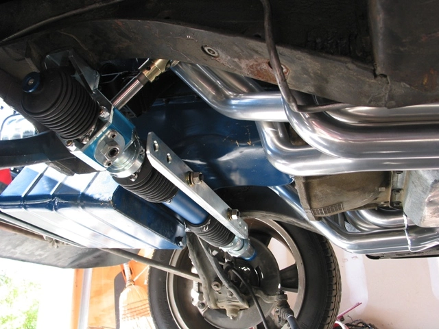

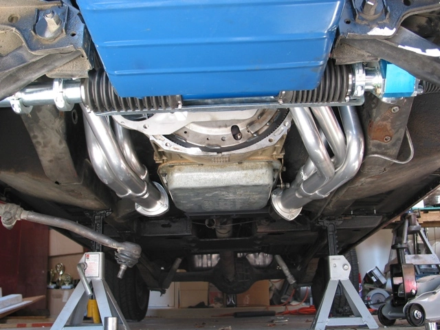

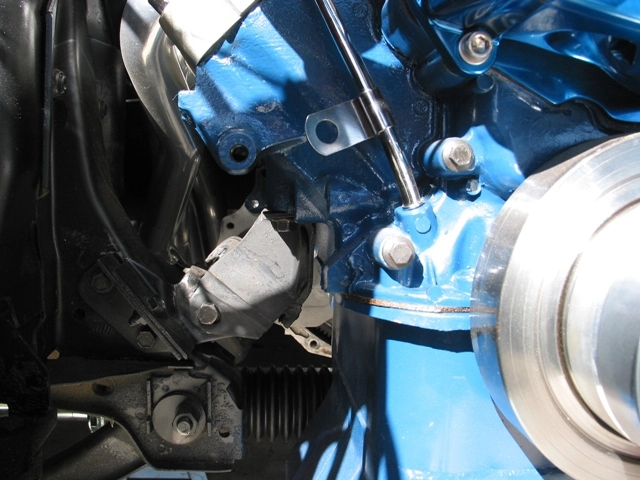

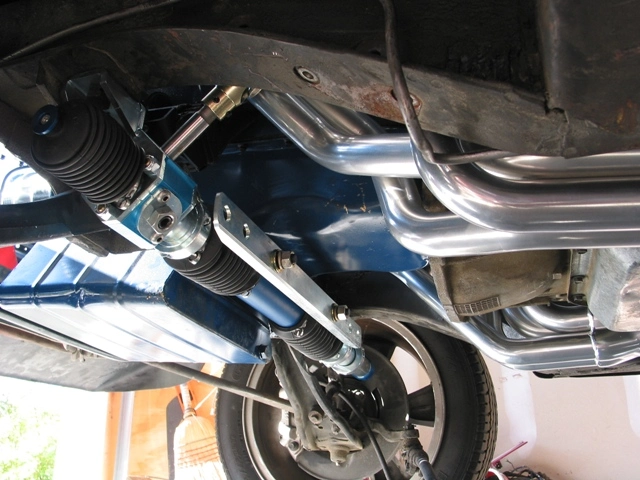

I put Hedmann Elite's (ceramic coated long-tubes) on my 67 with 351W, no issues at all in fact I did it in less than 20 minutes per side. There's plenty of room by the shock towers, did not interfere with aftermarket rack and pinion and ground clearance is great. They are the same ones used in 69/70 351W applications as stated above. Here's a few pics that show them.
