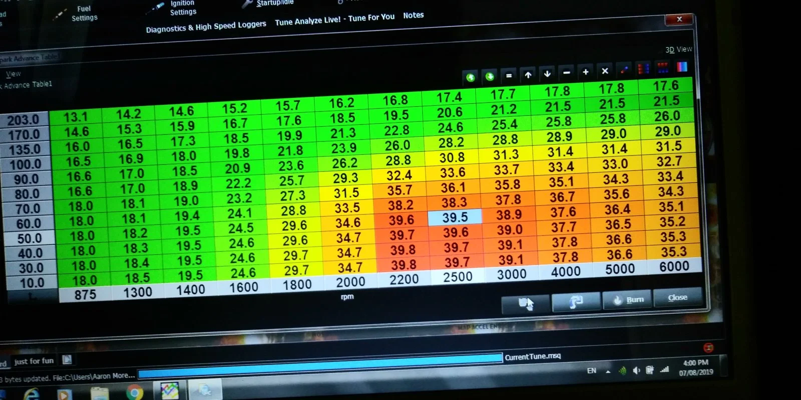

FastDriver said:
Mind posting a screen shot of your base timing table, now?
This is what im currently running, i pulled one degree from my cruising cells. Running 38 at cruise instead of 39.5. Its ok. But my setup tells me theres alot to be found. Ill post a datalog if needed with a tune copy

Looks like the stock a9l curve
Make 100kpa 33* if running aluminum heads and 93 octane. And blend down. You want around 28* at 1400

I haven't tuned enough combos to give that kind of specific advice. But, the comments I've read about total timing on aluminum heads are all in the 30s. Without Steve here, I've have said baseline it at 32*. So, I'm not that far off, I guess. After baseline, you need to read the plugs, and keep in mind that not all cylinders are created equal. The leanest cylinder is always the plug to read, if you're going to read one. Then, add timing 1/2-1* at a time and watch trap speeds. When it doesn't pick up any more, you're done. And, I believe in conservative tuning, because you will get bad quality gas from time to time.
My AFR heads liked 18* base the most. I guess the A9L would have been commanding 38* total minus any modifiers (see chart and adjust base timing by 8*). Seems high to me, though.
If Steve says anything that conflicts when my statements, listen to him.

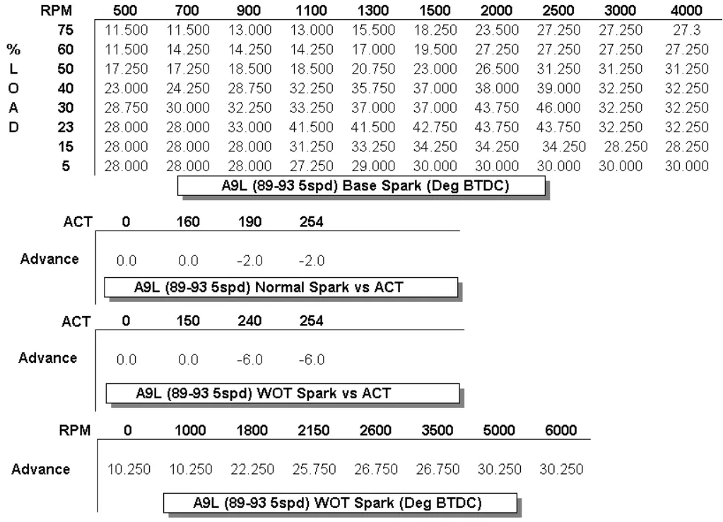

EFIDynoTuning
at the bottom there is an mbt reference chart
u can download the free custom tuning software for the ford ecus and open up the a9l2 custom base tune. Follow the directions for applying your mbt spark from the a9l2 write up and copy that base table to your tune.
