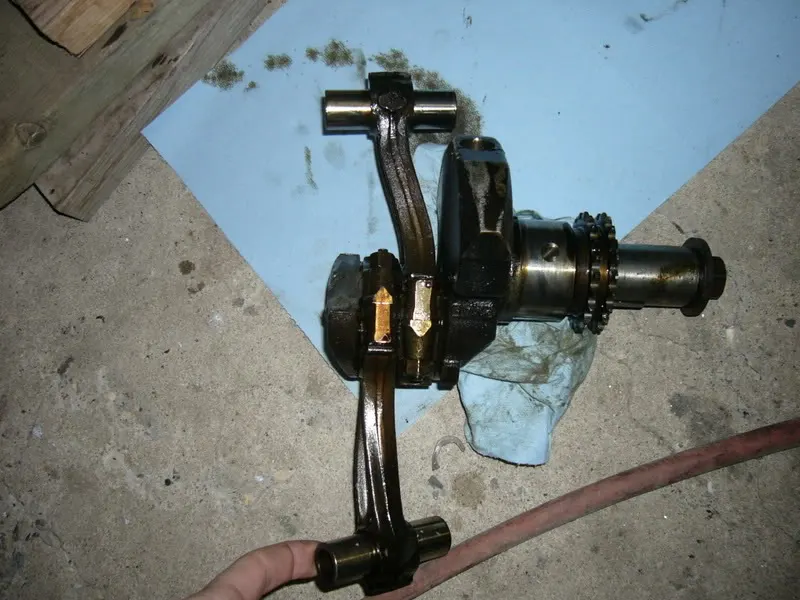

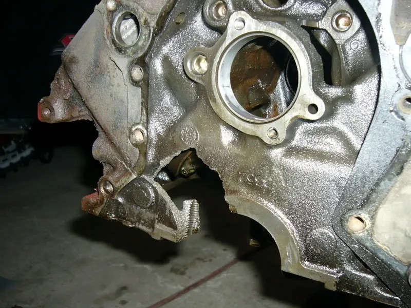

Sounds like the oil thins out(when hot) and you are losing pressure, could be the oil pump is starting to crap out, or the bearings are going south. When you change the oil, it is fresh enough to maintain good viscosity.
See pictures below for what happened when my stock gauge started to flutter at idle, thought it was just the sender unit as it was still running good, and would come back to full once you got off idle.
all of the main bearings where down to the copper when i took it apart, dont if it was the pump or not.

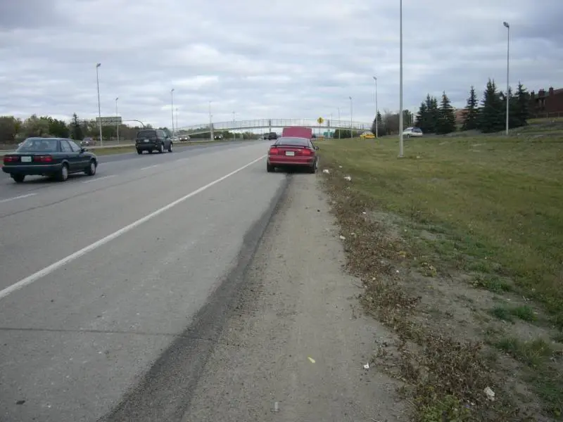

no different noises that i can remember, the car had a bad vibration though from the day i bought it until it blew apart that i never did track down. The car still ran good and had good power, but you felt it in your ass.
I was merging onto a freeway and got stuck behind a slow truck, once i could get around him i put it down to WOT in 2nd, redlined it all the way to 6100, shifted to 3rd and made it to about 3500 and after some bangin it was pure silence, creepy feeling. I had to run back about 200yrds to get the balancer and timing chain bits out of the driving lane.
