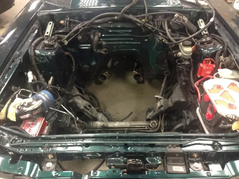

so taking tranny off tonight,then he will pick it up in the next day or so,i bought an arp hardened shaft and allen key oil galley plugs,hopefully ill have it back in by next weekend.

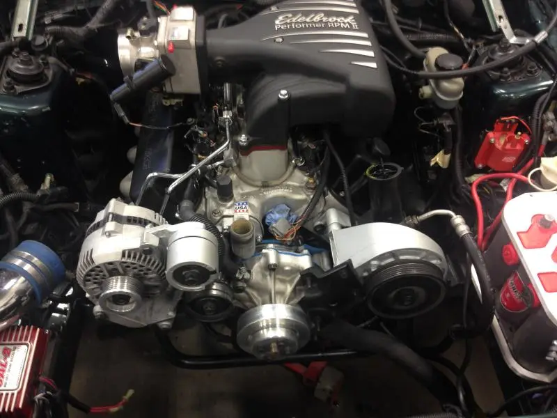

engine is back in!,went smoothly exept i had to cut the msd shaft a bit to make it work with the new arp shaft.
little clean up and shes good to go.
Reactions: 5.0notslow, stykthyn and TOOLOW91

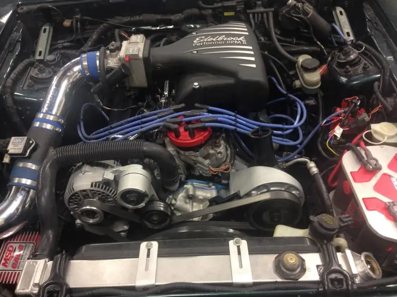

elarm1
Dec 17, 2010
1,428
652
154
N.Va
Sep 30, 2014
#93
  • Sep 30, 2014
  • #93
Looks like my motor... shoulda tucked them wires while it was out!

Oct 21, 2014
#96
  • Oct 21, 2014
  • #96
thought of that many times,but i was just going for a decent looking street engine bay....maybe next time....lol
