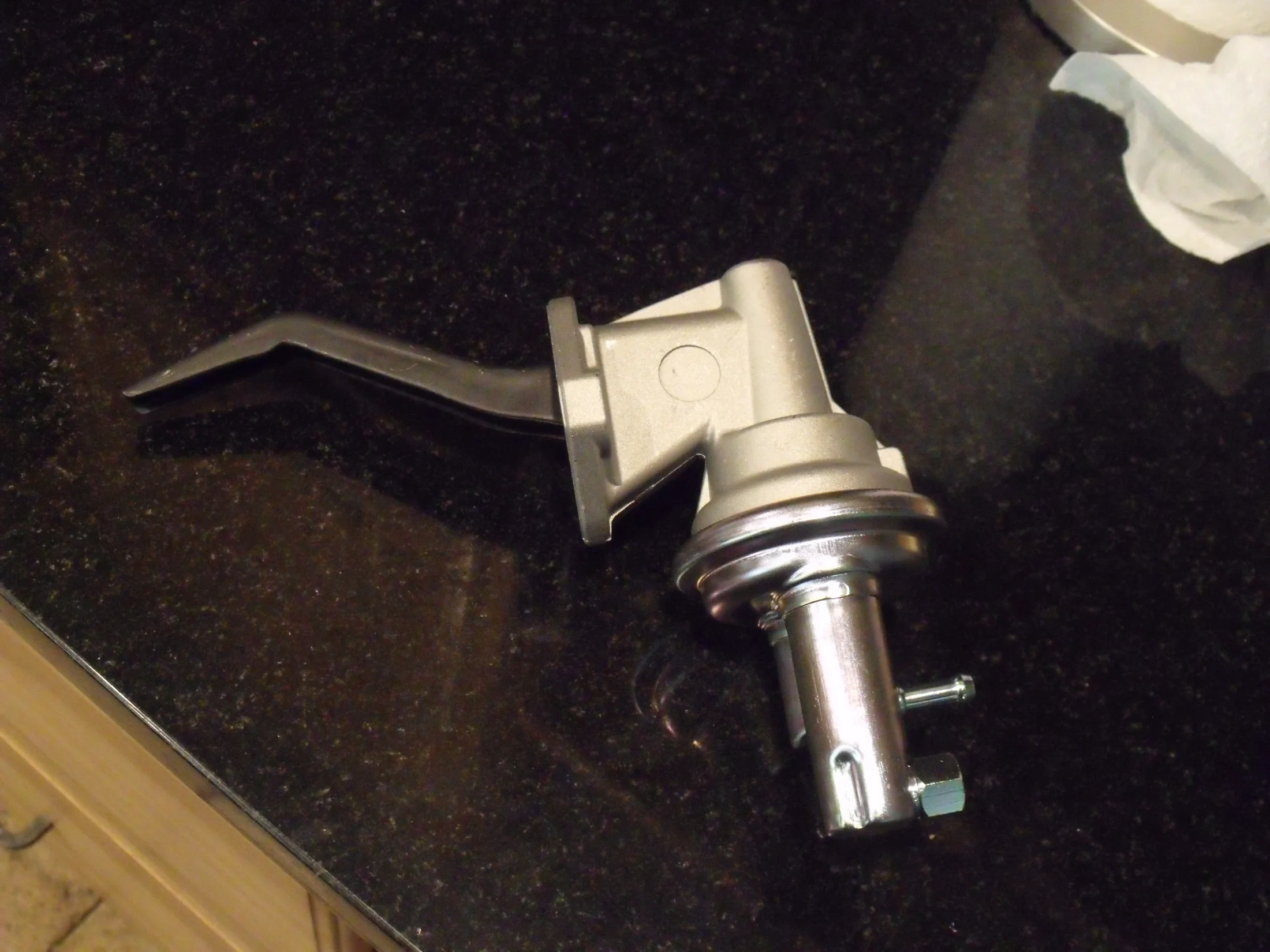

I have read where the mechanical fuel pump ( its a brand new carter) can leak past the diaphragm into the crankcase.....

I think you'll be good after changing the oil, maybe squirt a little clean oil into the plug holes and roll it over a couple times with plugs out, yes I have encountered a manual fuel pump leaking into the crankcase, but they were Brand X cars soooo :shrug:

My Rock Auto order should be here on Friday.... All of the local places had to order it, so I did it myself......
