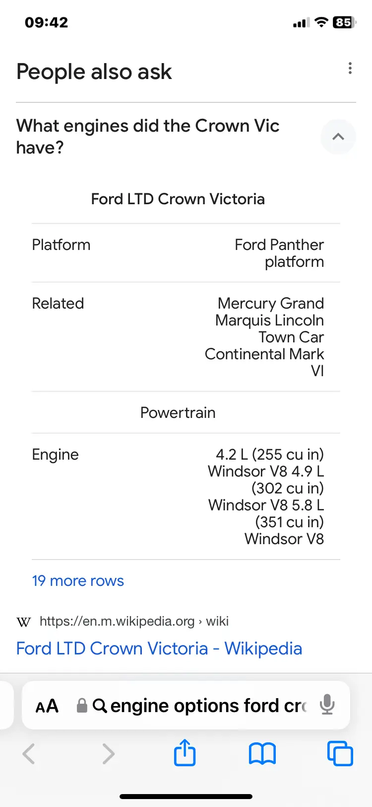

Didn’t the crown Vic have it mounted low on the passenger side? And as I remember, it didn’t matter which engine was in the car, all mounted there.

What Crown Vic had a 5.8? All I am aware of are 5.0 and 4.6 engines which ran from 1994-2009 (last production CV police interceptor). I’m almost sure none of the 5.0 engines had a serpentine setup but rather a two belt set up with manual tension.
I dove off into this pretty deep when putting an “06 CV front suspension in my “70 F100.

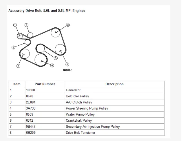

Ok, a quick search of Rock Auto does show two belts (1991 5.8l); in all applications of options, the V Belt only drives the smog pump. The Serpentine belt drives the rest. It could be two serpentine belts, but the AC is definitely driven by one of those.

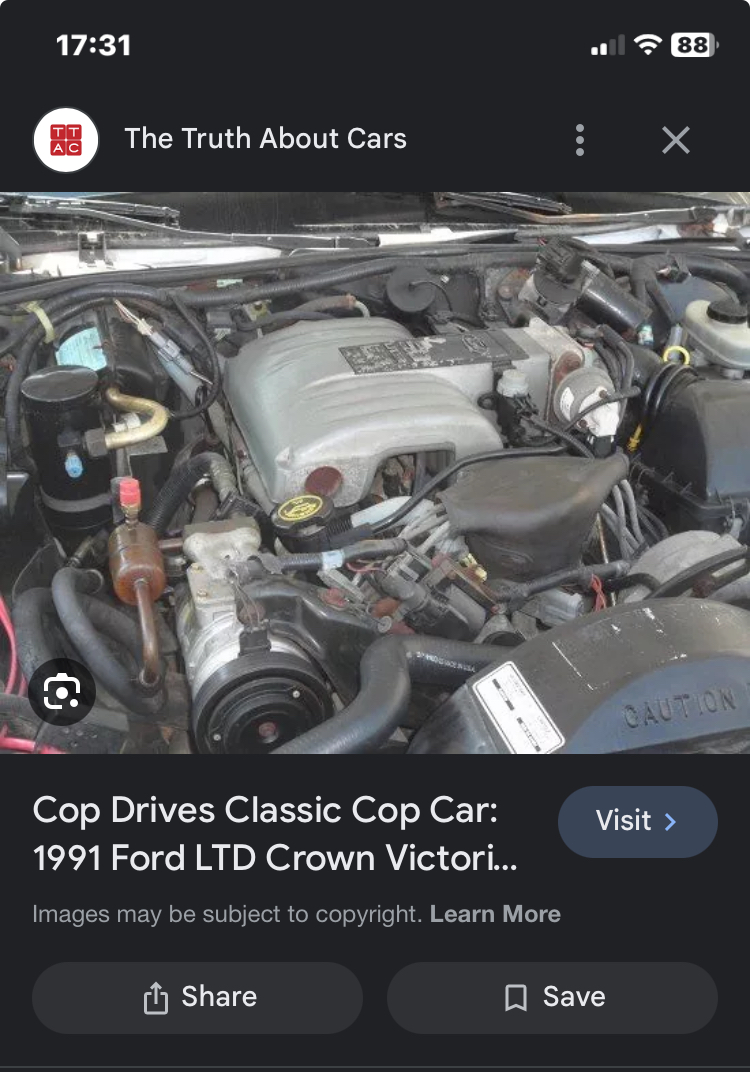

Here’s a pic of a 1991 Crown Vic 5.0, with the AC compressor on the passenger side with a serpentine belt.
Now, not low.
Reactions: nickyb

And not on serpentine belt but definitely on the passenger side.

Where do you see a v belt in that pic?

It's a serpentine alright. No idea what/how their accessory drive attaches but theoretically, you should be able to put that drive on a Mustang so long as there's nothing in the way.

I just got off the phone with an old salvage yard friend in Tx. He tells me, all of those 1991’s had the AC unit on the passenger side, and some luxury models of the Ford/Mercury had them in the place of the air pump, so lower. He also said, many of those were part of that junk your car for money back in the day, so availability is unknown. But, if someone could find either a belt illustration of the Grand Marquis or ? we might have a winner.
