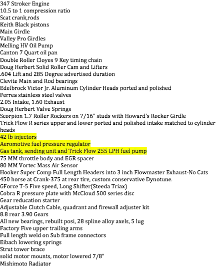

@85rkyboby So I just replaced the entire fuel system less than 2 months ago because I had a similiar issue back then. But this is what I have for the whole car and I will highlight the fuel components.
