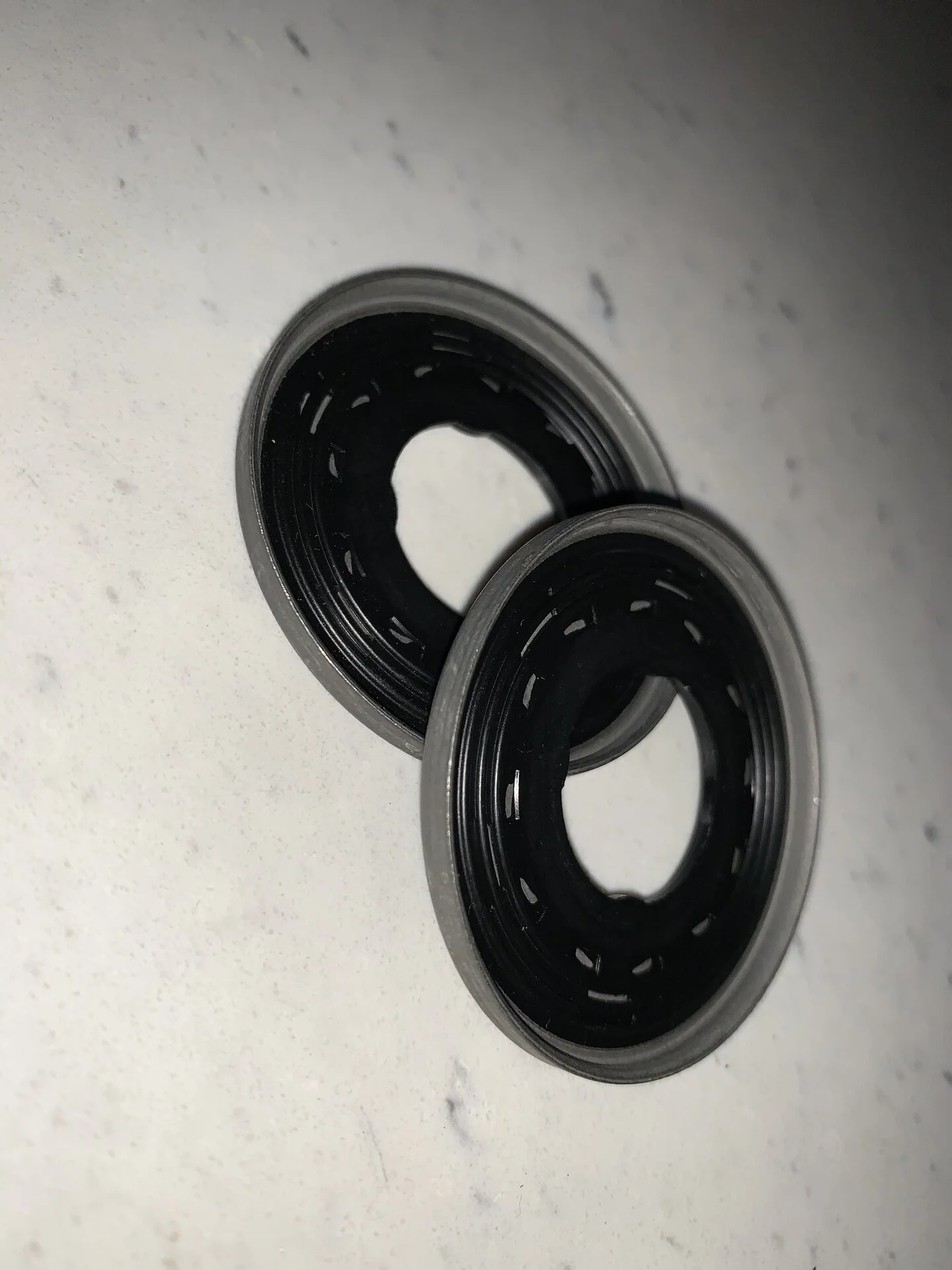

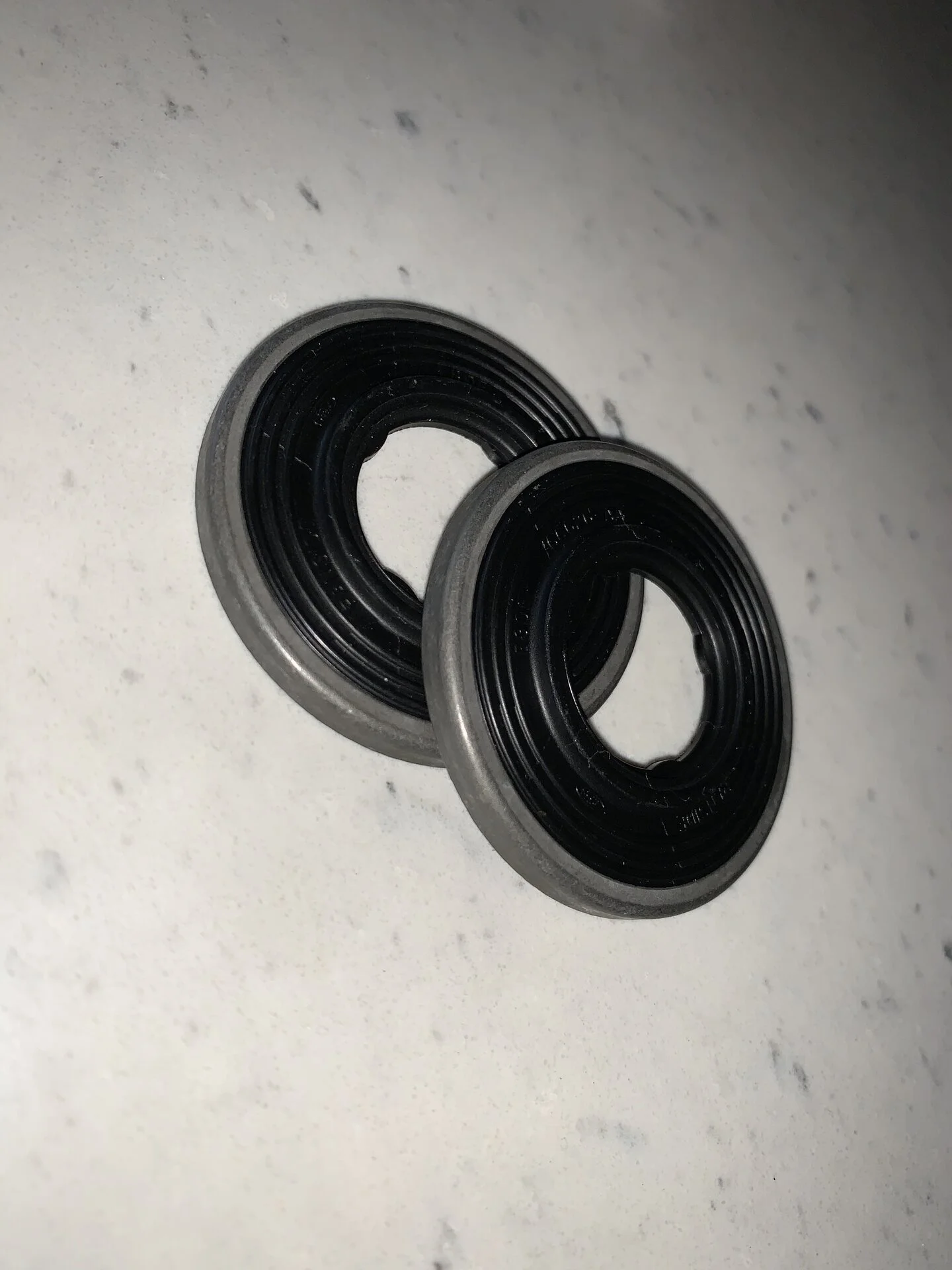

i see they have 2 different gaskets...
I have a 92 5.0 with an 89 motor. I have a leak at the low oil sensor even after a new ford gasket, but i think its the one from LMR..which seems to be the correct one in my application. Can anyone tell me the difference between the 2 besides that inner o-ring? wouldnt it or shouldnt it be the same and not make a difference? is the oil pan mating surface different or is the underside of the sensor housing any different? i mean, it looks like a smooth to smooth mating surface which either gasket could be used?
i just picked up these gaskets from a ford dealership parts counter part no e9dz6c626b at only $1 each. pretty solid piece. but damnit it says it does not fit an 89 motor, only 90-95 this is the gasket you need. i have a 92 with an 89 motor...i dont understand the difference between the years? anybody?
BTW, often the leak is not from the gasket but for the sensor itself. There is an internal seal that fails with age. The entire sensor housing mst be replaced if that is the case. Not a cheap part.
