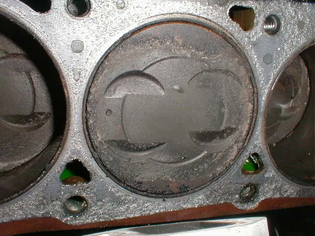

Here:
I tried to scrape as much off the engine as possible (I had a ton sitting on my headers as proof) using a razor blade. The rest I tried to scrape into the cylinders, so I could then spray the cylinders with brake cleaner and rotate the engines by hand to wipe the gunk out after the rings pushed it to the top.

It doesn't look like the 5.0 has oil drain holes through the block... the heads drain to the lifter valley? If so I don't think you could have got anything into the oilpan, though that is a lot of gasket material and would have been an issue on a motor with holes in the deck to the crankcase...
My other thought was that there was an internal oil leak, and at low RPM the pump couldn't flow enough to overcome the escaping pressure. But I don't know how a head swap would do that unless something was really fubared with the seal of the oil feed to the heads (leaking to lifter valley if it is adjacent to there?) or the installation of the rocker shaft. I got no idea how the lube system on this motor is set up though.
