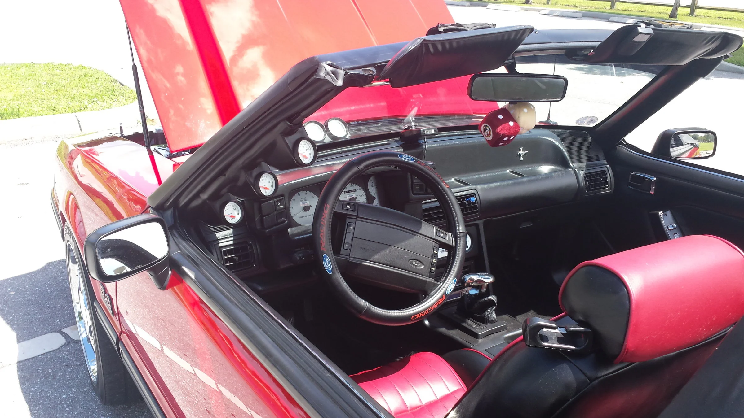

FWIW, I run autometer electric oil, water, and volt gauges in an A pod pillar. I didnt want to run any lines inside my car. Mechanical gauges will always give the most accurate reading, but I've never had any issue with electric ones as long as they are properly grounded. Know that you cannot use stock sending units for autometer gauges,and likewise vice versa.
