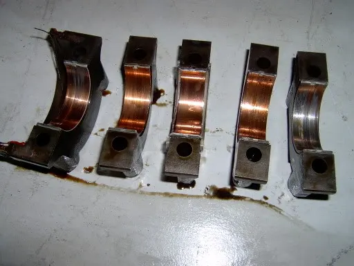

Hopefully your bearings don't look like this:
it is on a rebuilt motor and has about 12,000 miles on it, and i hope my bearings don't look like that. now that makes me think, should i take out the motor and check everything or not.

My old motor had 10psi of oil pressure hot and about 55psi at cold warmup....ran like that for over a year, never gave me a big problem, i tried 10w30, 10w40, 20w50 still did the same really. i had a noise but that was from one rocker, oh wait it did have a real bad knocking noise around 5,000krpm and up but that had occurred just a month before i pulled the motor. and when i pulled the motor and bearings, they looked just like Mikes ^^^, it can never hurt to pull it and check it out and throw in new bearings and rings etc....but that never happens, you might end up doing a complete buildup if you already dont have a nice combo now. i said i was just gonna rering my motor and somehow ended up with a nice H/C/I combo
