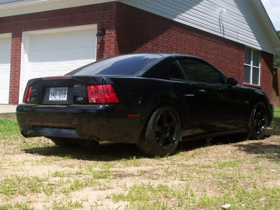

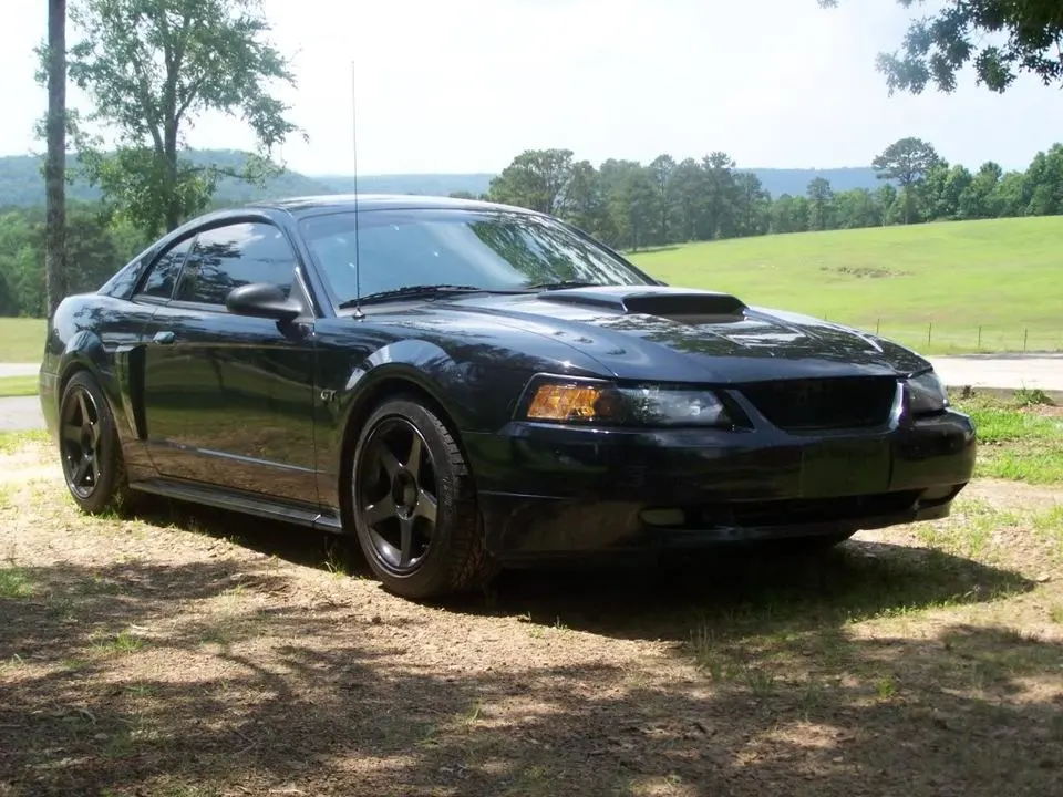

Well yesterday, a friend and myself decided to go ahead and lower my car. It's pretty much slammed. It looks sick imo. It rides like crap, but im hoping with some new shocks and struts (still has the factory ones from 02) that it will ride a little better. Anyways, enjoy!

ya shocks n struts will make it ride a lot better, if its just a dd i would suggest bilsteins. also some cc plates will help with the alignment.
crazystang25
Jan 25, 2009
492
May 24, 2010
  • May 24, 2010
and ya it looks pretty good too

Looks real good. How much did you lower it? What kinda springs? What size tires do you have? Since you brought this up i figure i'd ask the questions since im about to lower mine and want to get it right the first time.

Looks nice. Did you purchase new springs or did you cut the stockers? Either way, I'd still recommend cc plates

looks awesome man! what springs?

looks nice but your pretty low. I second what others have said. I wouldn't even say it's optional, you need cc plates and a bump steer kit. Without the cc's you'll be eating tires, then without the bump steer you'll be jumping all over the road.

We cut the springs. We cut 1.5 coils on the front, and 2 coils on the back. I plan on doing everything that was mentioned. It really just depends on how it looks once I install new rear shocks, because the ones that are on it now are shot. If it still rides rough and sits about the same with the new shocks, I will go ahead and put new poly Iso's in it.
My game plan is to add MM cc plates, Steeda X-2 ball joints, and Steeda bump steer kit. I will eventually end up putting H&R springs in, or just go to coil-overs. But I didn't have that kind of money and was tired of the car riding high.
I will end up taking this car to more road courses than drag strips. So hopefully some road racing suspension will be installed this year.

dam, you cut the springs???
looks good, but that sounds like its bumpy as hell.

Yeah that's what I had to do so it would set level. In that picture I am on uneven ground. On a flat surface, it sits level. These cars sit with a rake from factory.
