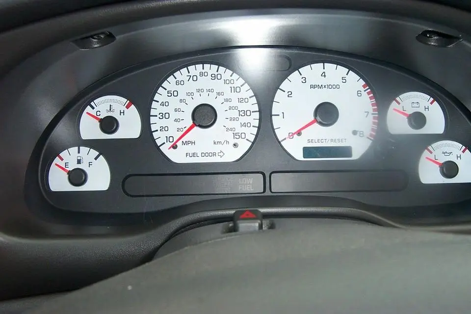

Just installed my MAC white face gauges today. And for being rather cheap
gauges they look pretty damn good. install was a snap. reinstalling the needles was a bit tricky but fortunatly i used the scan tool at work and was able to position them perfectly. And as for the lighting issue i heard alot of people complain about, all i noticed was that they seemed to be not as bright as the stock gauges but seemed to light pretty evenly without any dark spots. I think they seem to be good gauges for they the cost of them.
can't complain. a little info for anyone thinking of getting mac white face gauges.
http://i5.photobucket.com/albums/y177/blackstalion666/mac1.jpg
heres a pic of them during the day don't have any night pics yet. But heres how they look installed. and the slight blur is my camera had a smear on the lens.

Chill Derek, he provided a link to the pic. OK, OK, here it is for ya...

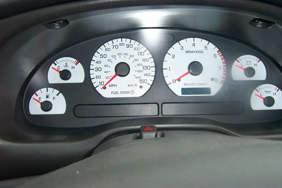

Here's a photo of my MAC's
They are great in the day, night they light up fine, but they are kind of hard to read at dusk or dawn.
