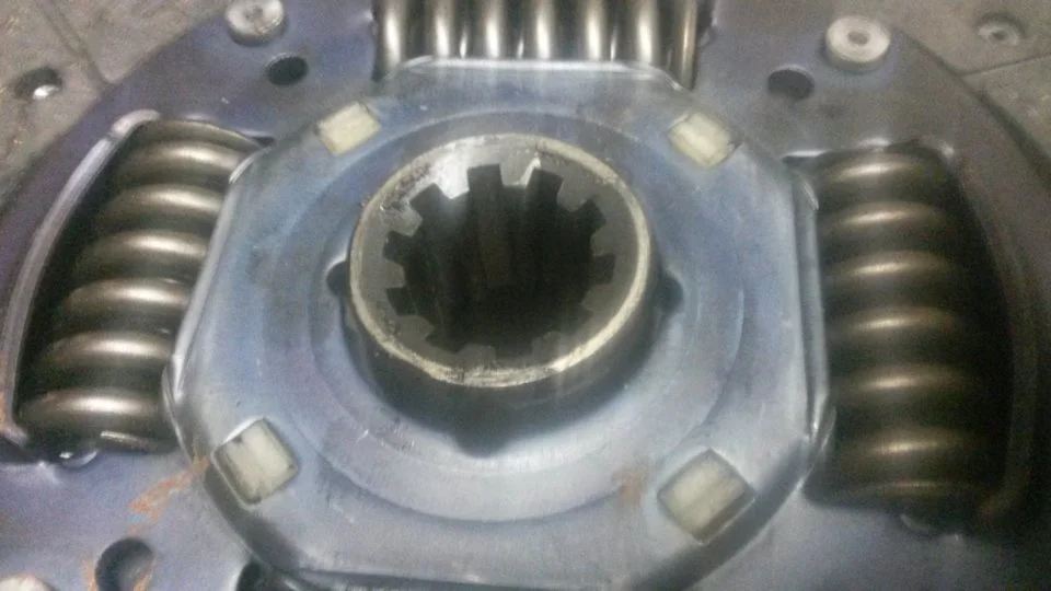

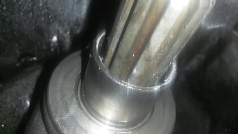

So it took me 4 hours to get the transmission off of the engine and thats after everything was take off. Lol what happened was the shaft that the throwout bearing slides on and the center of the clutch disk got pressed together. Idk if this is the wrong disk and the center sticks out more than normal. Not making much sense to me lol

The flywheel side is completely flat. The side facing transmission sticks out quite a bit. Looking at other kits they dont seem to stick out as far in the center. Rest of the clutch seems fine its just the very center part that the tranny shaft slides into was smashed into the Throwout bearing sleeve(part the bearing slides back and forth on)
Looking at the pics and comparing with the multiple clutches I've installed the disc is not correct. Either the wrong part or they manufactured it wrong. The sleeve and disc are obviously not supposed to come into contact with each other.
Glad to hear. Was hoping it was a :poo:ty disk and nothing major. Anyone have an old clutch laying around that can measure out about how much it stick out? This things upwards of 3/4 of an inch and the ones i seen when i googled it had to be 1/2 inch or less.
