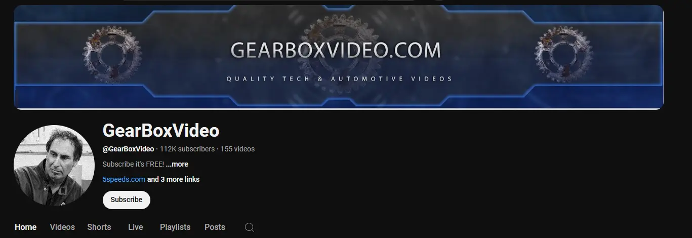

My 3550 has been operating poorly since I installed it and, truthfully, I've been afraid to do anything about it. Transmissions have always been a metal case filled with voodoo and sending them off for service is an automatic $1k just for them to touch it.
Well, I found this guy's channel yesterday and I have REALLY enjoyed his videos and he has taken enough mystique out of how the manuals work that I'm comfortable enough to tackle taking mine apart. He covers a lot on Tremec transmissions, from T-5s to 3550s and beyond. ]
He's quirky but the info is really digestible. Also has a website that sells parts if needed.
