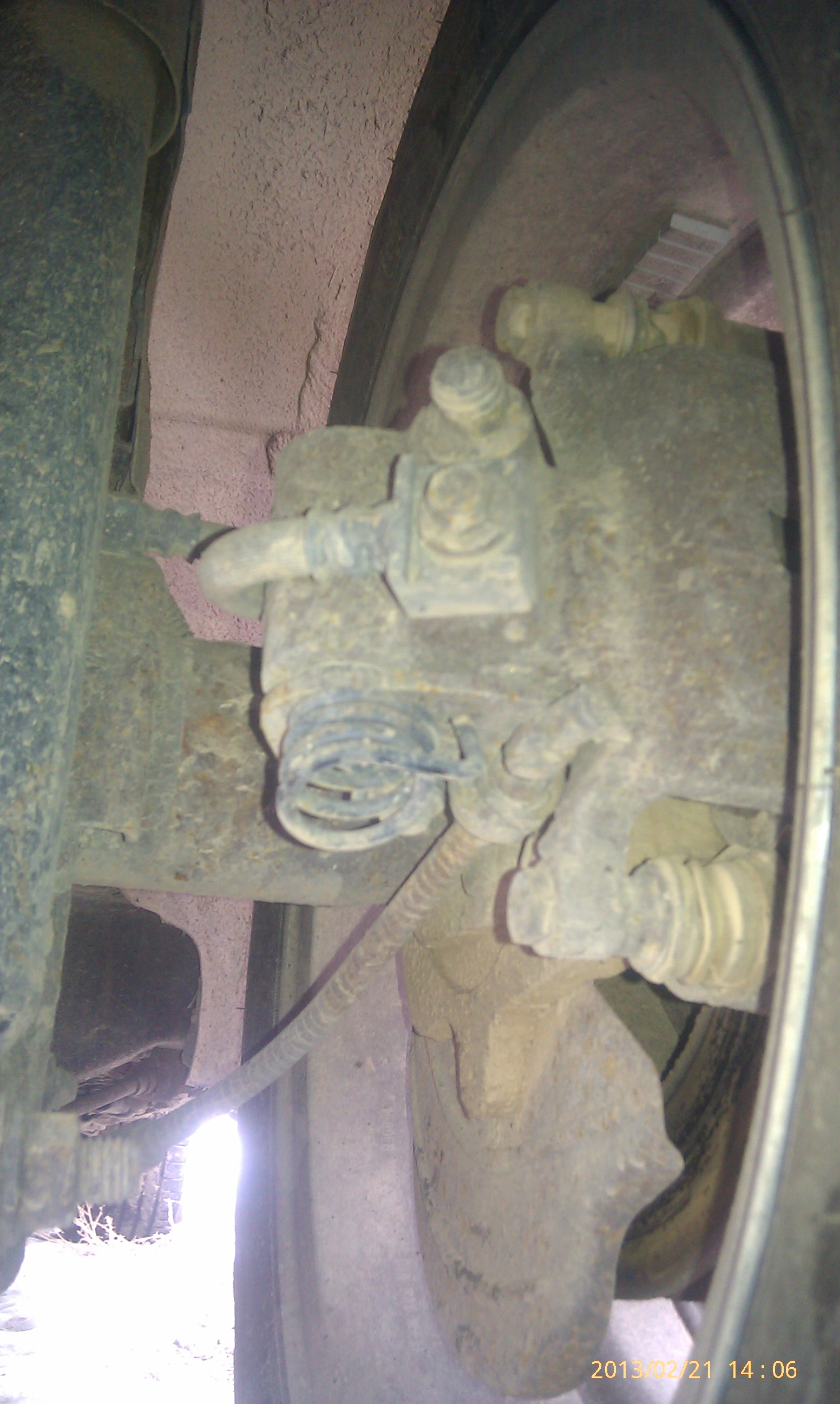

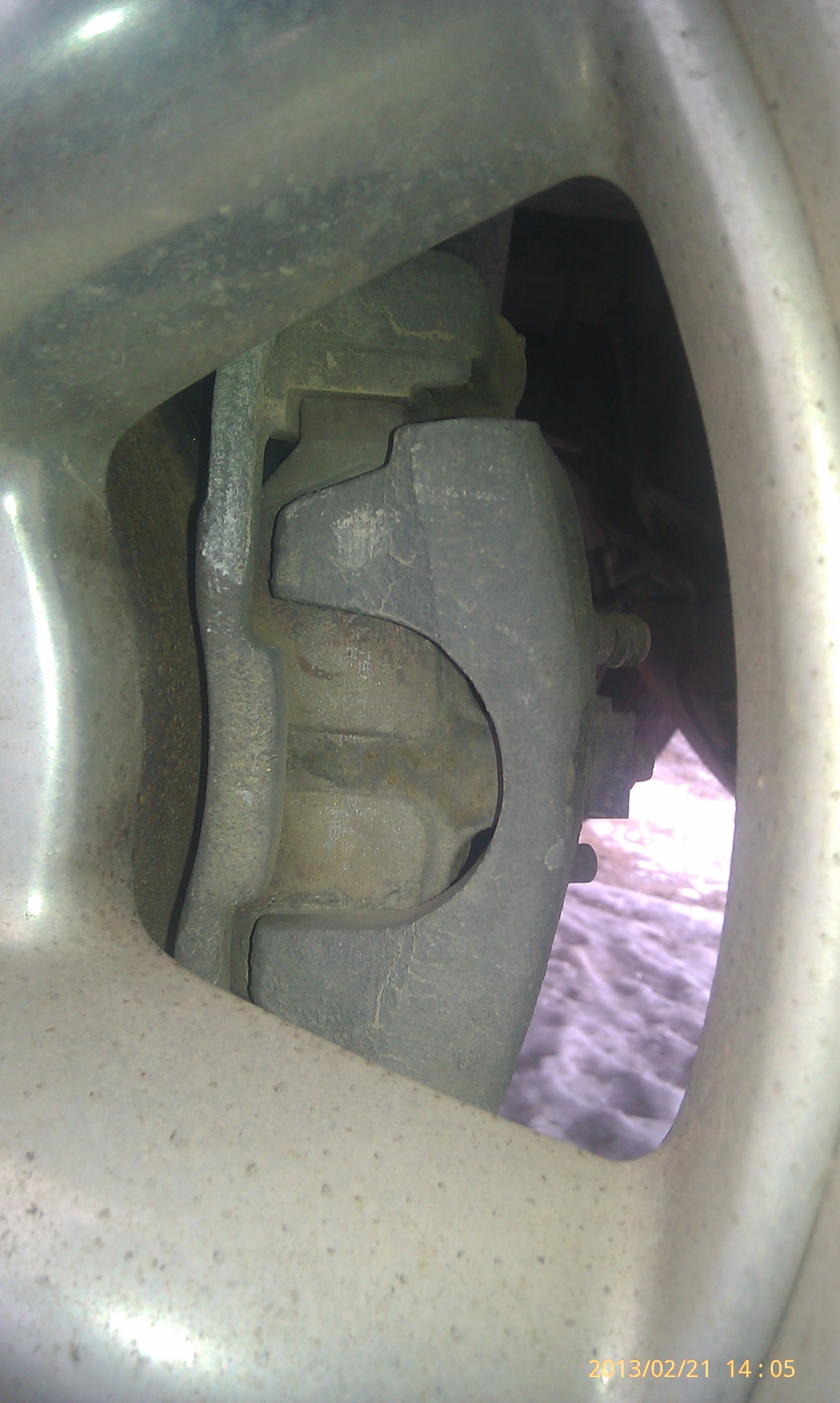

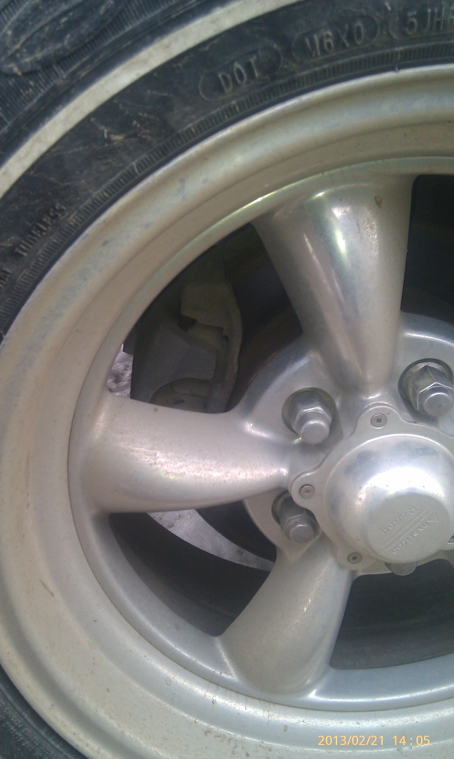

Ok, I was able to get a shot of the brakes. Here they are.

They look like. Sn95 brakes
From the back they sure do.
From the front, you can tell the pad is longer than an SN, or even the TC/SVO pad.
They do. They are very similar, but slight differences. I'm not sure of the piston size though. But it's a 10.5" vented rotor vs the solid rotor found on the 94+ GT/v6
The e-brake looks VERY similar to SN95 e-brake. In fact, it looks pretty much identical. I bet you could just run the same cables as you would with an Sn95 brake conversion and be fine.
Rotors, calipers and pads are available for those brakes. I wouldn't sweat not being able to find parts in the future.
