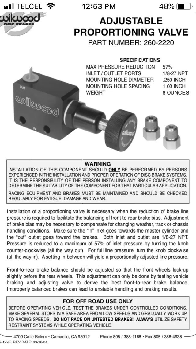

The wilwood adjustable proportioning valve has ten turns from all closed (Counter clockwise) to full open (Clockwise). I adjusted it eight turns clockwise and still not having good rear brake pressure bias. what should I do? Should I completely delete the stock proportioning valve??? My rear brakes are not working properly even adjusting the adjustable proportioning valve eight out of ten turns clockwise?

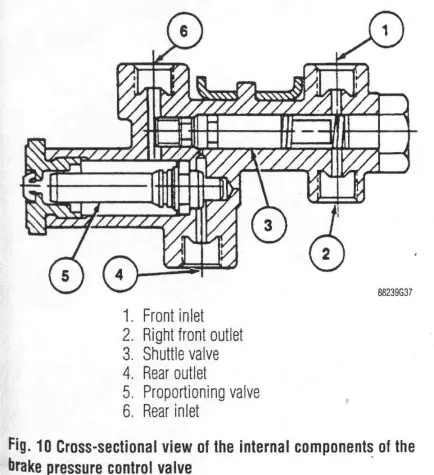

So a Wilwood manual proportioning valve has a maximum decrease of 57% of the system pressure so 43% of the pressure will still go to the rear brakes with it pinched down as far as it will go. The reason for stating this is even with it pinched all the way down the rear brakes will work.
When you say that you gutted the stock combination valve (OEM brass block that al the brake lines go to) did you remove the plug on the front of it along with the piston and spring that were behind that plug and then replace the plug with a solid one? There is no need to mess with the rear plug as that is the shuttle valve.

I don’t think I misunderstood the instructions, it says that for full pressure or fully open the valve’s knob must be fully in turning it clockwise…
“Pressure is reduced to a maximum of 57% of inlet pressure by turning the knob counter-clockwise (all the way out). For full line pressure, turn the knob clockwise (all the way in)”
I bleed the rear brakes with the knob all the way in (fully open)

I'm sorry. I am mistaken. You are right. Full rear pressure is turning the valve fully in.

Having agreed on that, how the hell my brakes are not as solid as they should be if I almost fully opened the valve with eight out of ten turns clockwise from from fully closed to fully open? Beyond my understanding!
