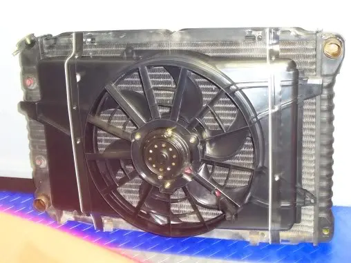

I ordered a replacement fan for 92-93 taurus 3.0L engine...same motor as the 3.8 with fewer blades. Running a DC controller myself I can say with a fairly solid HCI car in 100 plus degress my taurus never ran 100 percent fan speed for more than a minute or two max on any given day...and temp was rediculously steady. I can only imagine what a mark8 fan would do. Here's the mock up I used on an old rad so you can see the limited size of the taurus fan...mark fan covers FAR more area. However the taurus fan is available at 70$$ brand new out of the box from any auto parts store.
