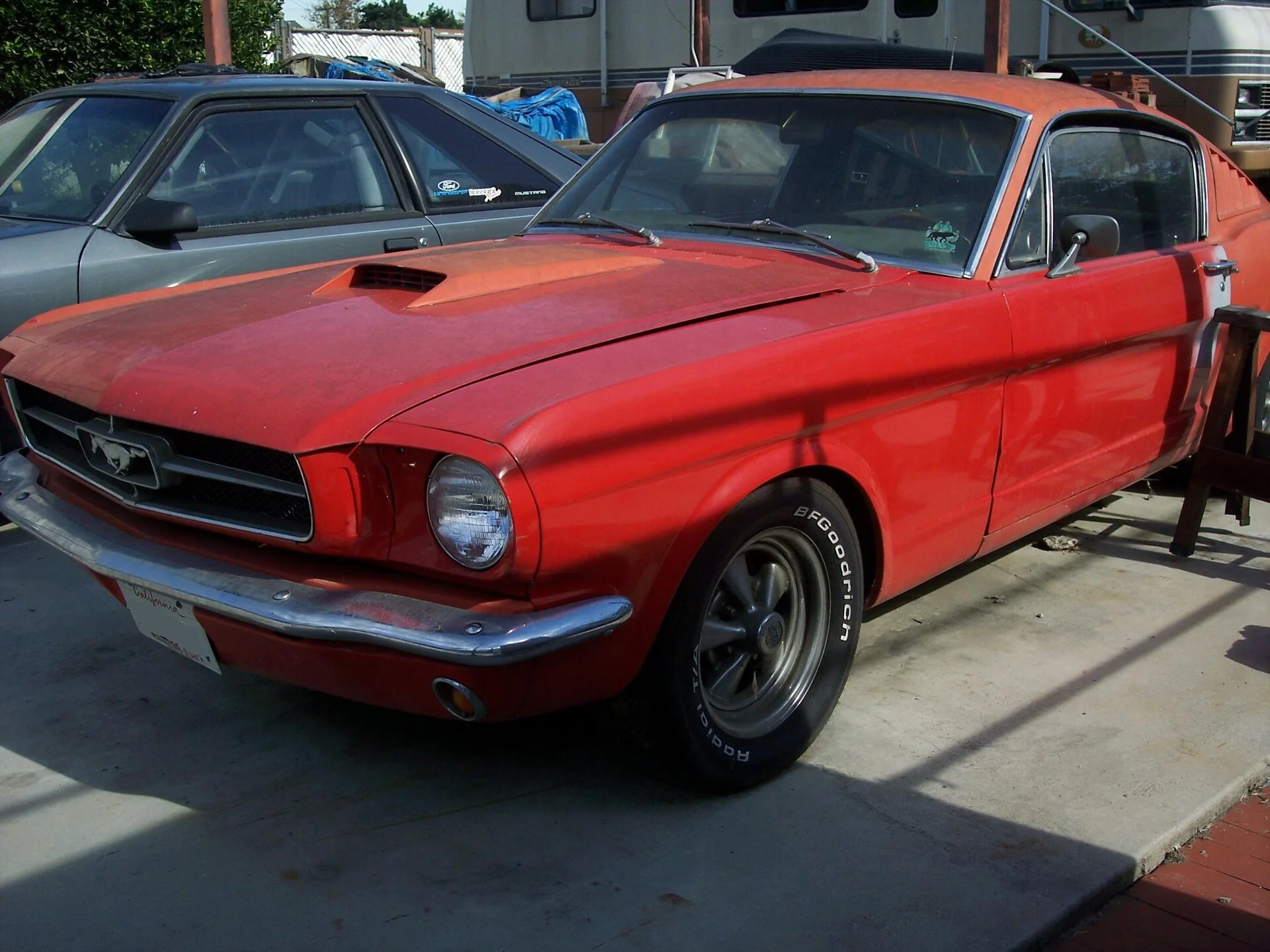

So ... I'm about to do something incredibly dumb but I think its going to be a hoot.
I bought this 65 Fastback with my dad way back in like 98. Drove the wheels off it in highschool and whenever I came home during college. I worked most of my summers out in New Mexico on a ranch and had no need for it out there so by 2006'ish, she wasn't running anymore. Well all know what happened in 2008 and like many others, I was out of work. I made do for two years doing temp labor and then joined the military. I spent the next 8 years bouncing around between Charleston, SC, upstate NY, Groton, CT, Hawaii and finally Virginia Beach, VA where I currently am. Didn't have the time to work on it or drag it along all over the country so it sat in my parents back yard in So Cal. Long story short, the car has sat for probably 15 years and now I'm out, have a house with a garage and not moving any time soon.
I looked into shipping companies and well ... 2000-2200 for a non-op car and while it does get the car cross country (So Cal to VA), it costs me 2k and I still get a non-op car. If you're smart, you might know where I'm going here. If you're retarded like me, you DEFINITELY know where I'm going with this. Its time to drive the beast 2700 miles cross country after it hasn't run in 15 years. I've got my brother and a buddy on board for doing some of the repairs before I get in town.

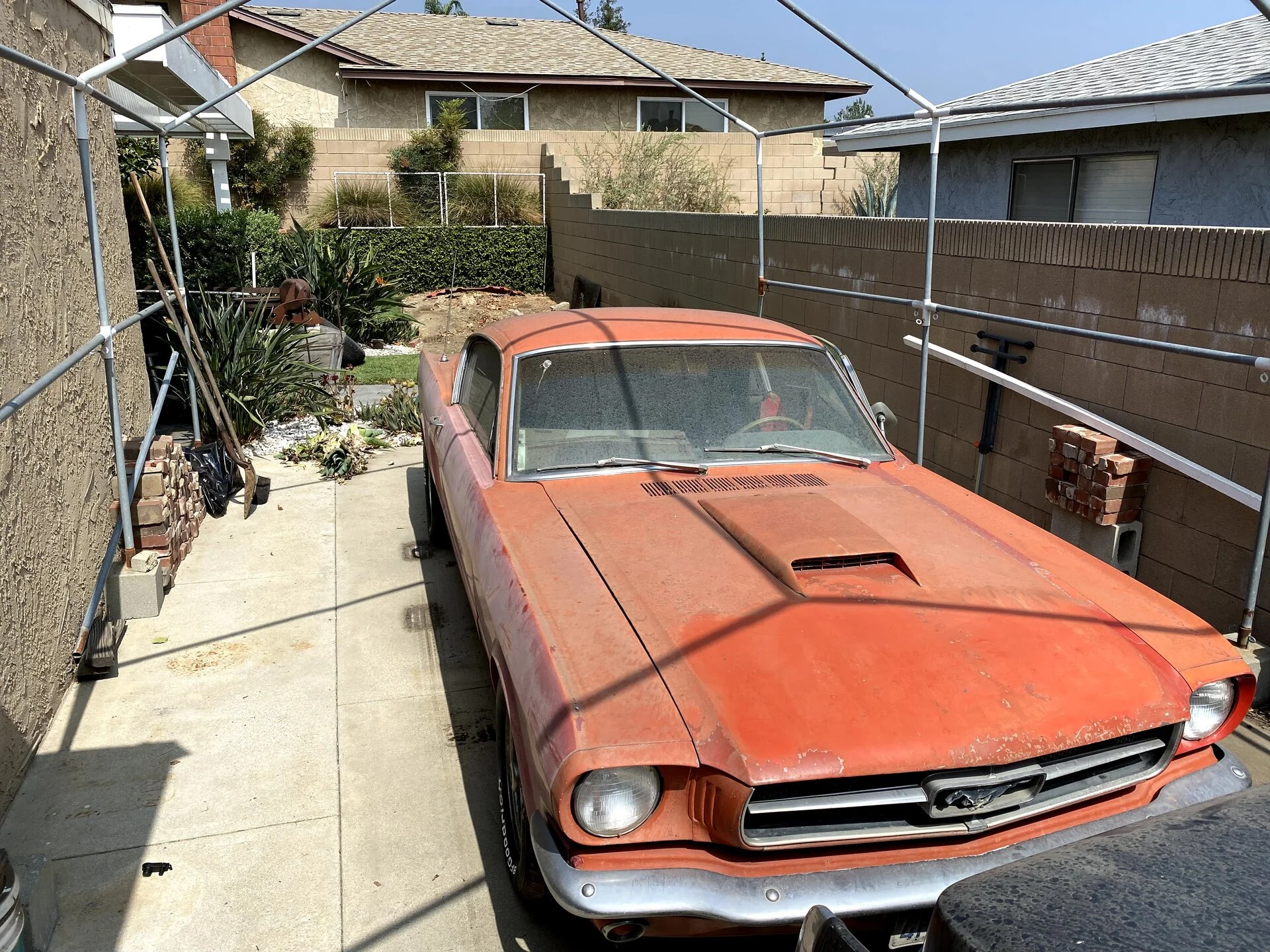

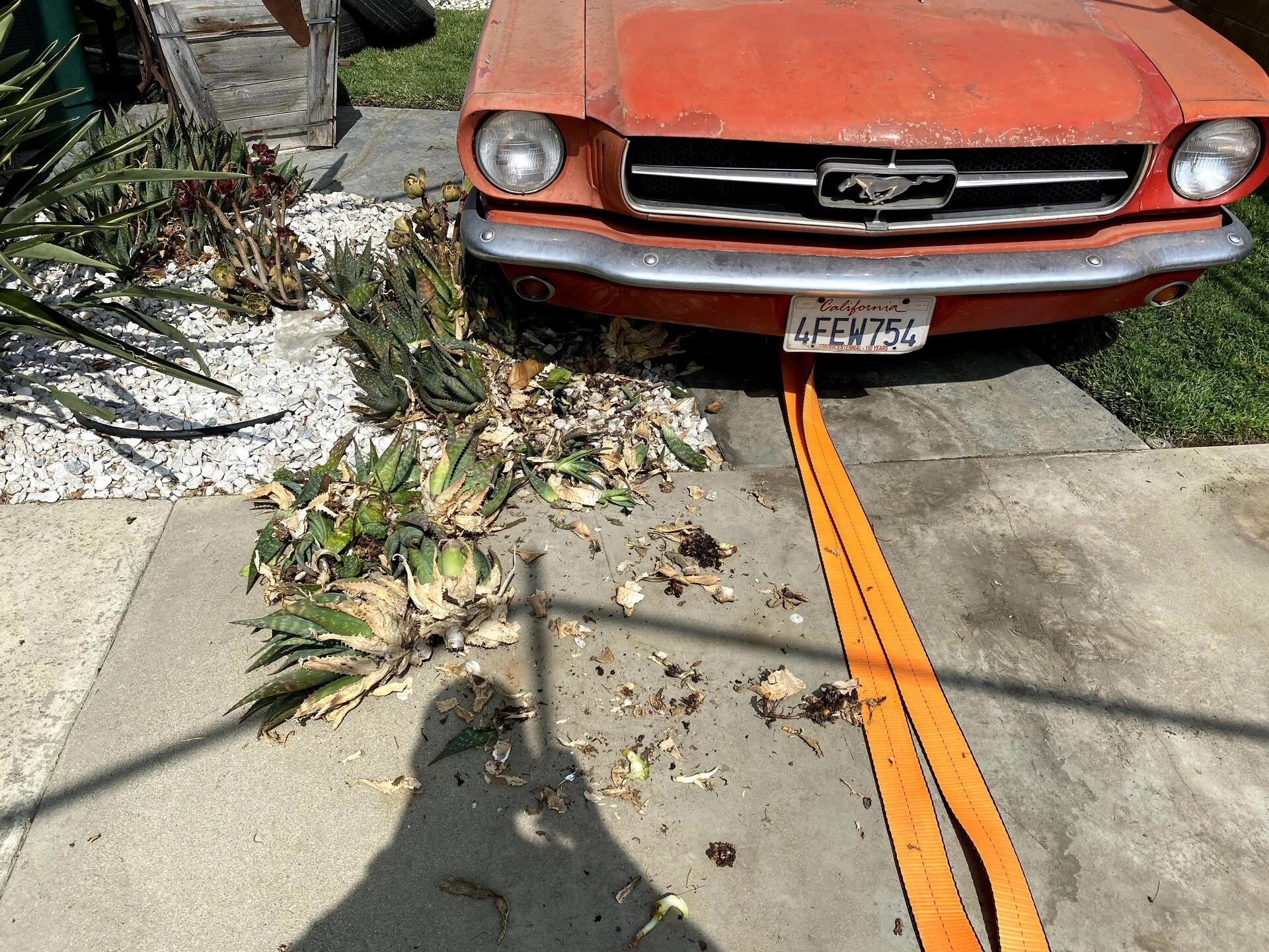

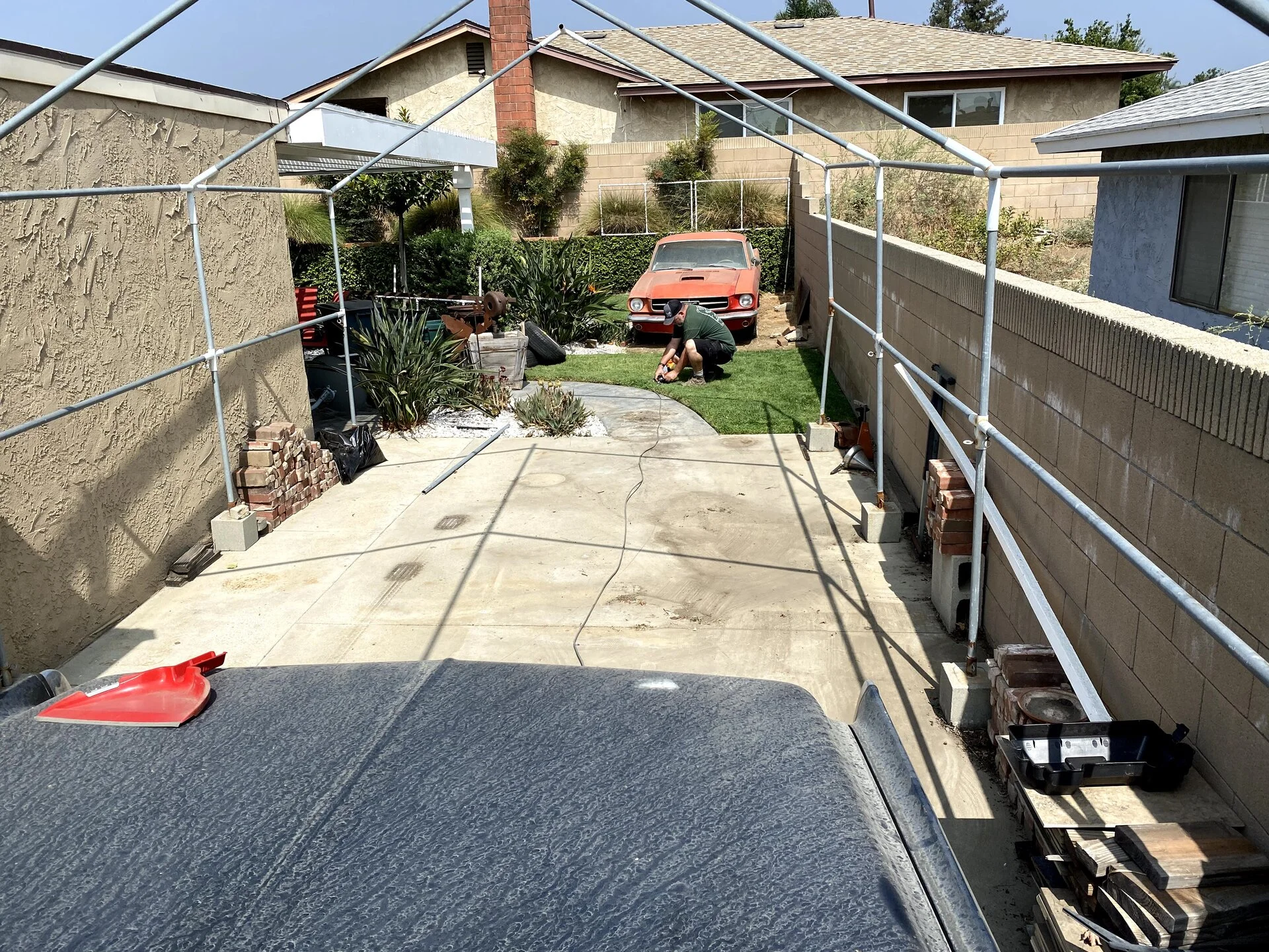

Progress ... and my mom may be slightly pissed that her plants got ran over. She's more happy the car finally moved after a decade than she is mad though so I call that a win. My brother and our friend were able to get my 67 Imperial moved forward and the 65 pulled up onto the concrete so they can get cracking on the tires and brakes. That's the furthest she's moved in at least 10 years.
