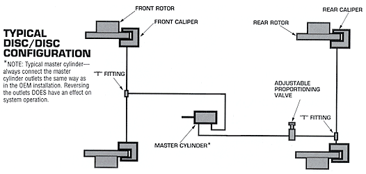

If so I'll setup my system like this:
(I modified the drawing found on this page: http://www.hot-rod.com.au/builder/brakes.html)

Another question. If I choose to hold off on putting discs in the back can I still use the SVO (4-wheel disc) MC and dial in the Wilwood prop valve to make the drums work in back nad discs up front?
