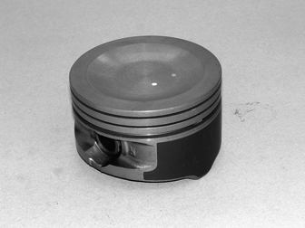

With a safe tune -- one that has lots of fuel and little timing -- you can probably rock 400-450 with a good amount of reliability. Although the rods are spindly and comparatively weak, it's detonation that really threatens the shortblock: the pistons are pretty brittle and have very thin top ring lands:
Detonation is almost assuredly going to snap off a portion of that ring land which will start the motor down the slippy slope of self-immolation. To stave off detonation you need to stay conservative with the fuel and spark. This means that if you find yourself tiring of 400rwHP after a while and get the itch to downsize a blower pulley to make some more power, you need to really think about what you're asking the stock parts to do.
