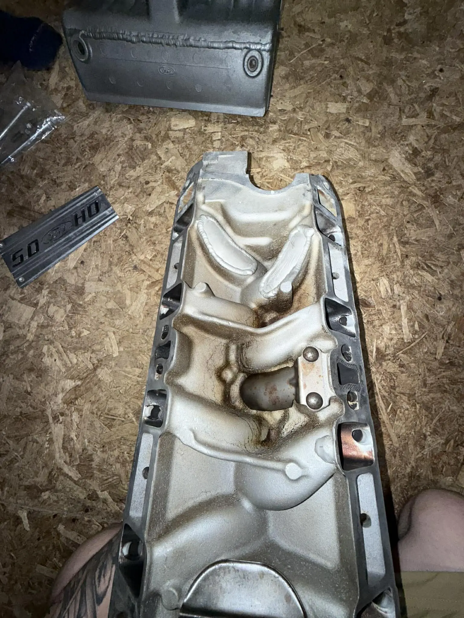

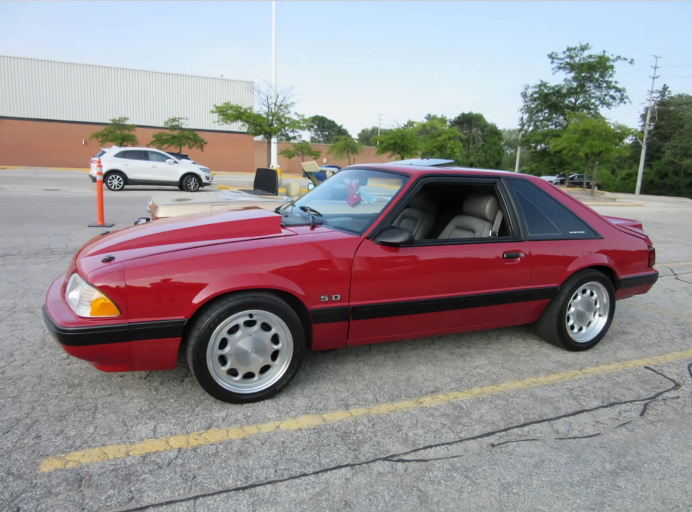

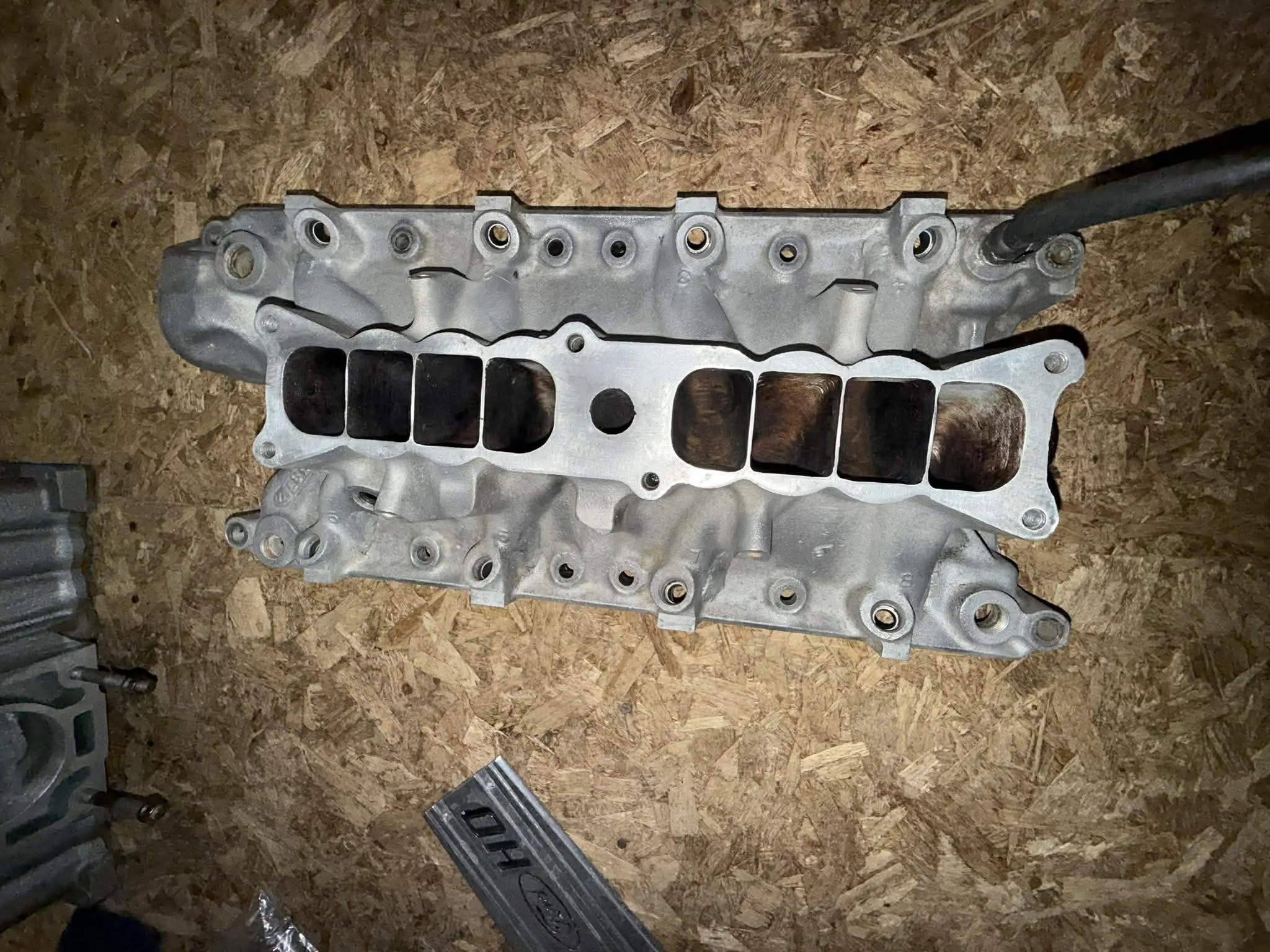

So I have an 88 LX I'm looking to do a top end budget build just because I find it all very interesting and at this point a hobby.
I picked up a professionally ported stock upper and lower intake manifold I plan to install, I got it for $400, and also picked up a throttle body ported to 65mm for 100
I don't really want to bolt these on with stock cylinder heads that aren't going to compliment them.
I've seen a few nice ported e7s on marketplace for great price as well as gt40 heads that just came up ( but dont want to run risk of issues with headers)
Now I dont plan on replacing the stock cam right now , hearing that 1.6 or 1.7 rockers can increase the stock cam lift a bit and is actually a good performing cam
I'm wondering on what people can tell me about cylinder heads , I really like the option of having stock parts ported out for a bit more power.
Also wondering if I'd need to increase injectors from the 19# I have right now to 24# ?
Im not looking for a race car , it's a summer cruiser but just want to tinker with things a bit and learn, and if I can add a little bit more kick to the ol girl its a bonus. I've had it for less than 2 years
88 mustang Lx
CAI
MAF converted
Electric fan
Underdrive pulleys and ac deleted
Long tube headers, mac cat back exhaust
3.73s

Im not sure if my photos attached , the intake i picked up is ported by dasilva racing in lntario

I got a ported intake done by dasilva racing , don't know the flow numbers , by the looks of it i can't see it performing a lot less than a gt40? Ill try to upload pics. I did when I posted this but don't think they uploaded

Its the stock style throttle body , exact same but it measures 65 mm and a plate to match was installed. The guy had this done years ago who I got it from .
My opinion, I wouldn't have bought that intake, it will move a fair amount of air, more than a GT40, cobra or exploder intakes, works well at high RPMs so needs heads (at the minimum) and cam to match, even just that intake and a good flowing head it will be a beast for about 10 feet and be a dog the rest of the time.
So you either match heads and cam to that intake which will give you a narrow power band to work with likely in a higher RPM that's not 'street friendly or do what has been proven to work since God made gas, example:

Got ya, im just wondering if these move the same amount or more air than gt40 why is everyone telling me they wouldn't of bought them ? I see gt40 intake manifold come up for above 400 , and i paid 400 for this one . So kind of just wondering why it was a mistake on buying this and the 65 mm throttle, would it not compliment the 175 cc heads you mention ?
That intake is designed for power in the upper RPM band, basically it's just started breathing when the stock cam falls off, so it would be a dog in low rpm cruising..
