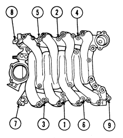

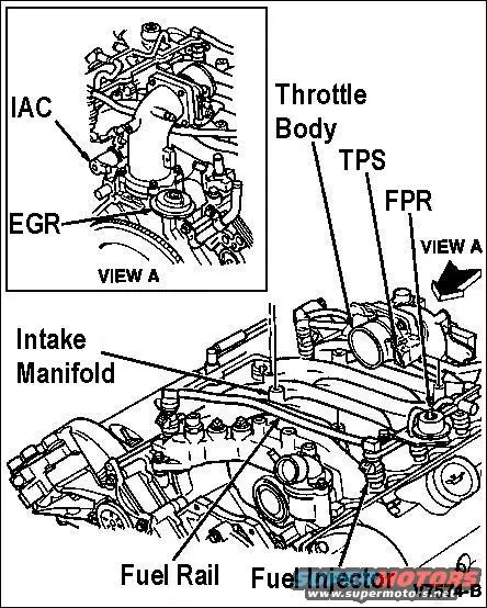

1992-1995 intakes on the 4.6 looked like this
